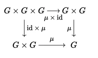

You mentioned that you're interested in associativity in particular. So we start with a diagram in $\mathsf{Aff}_k$ expressing the associativity of $\mu$.
the associativity square

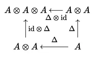

If we hit this with $k[-]$, and we write $A = k[G]$ and $\Delta = k[\mu]$, then we get a diagram
the coassociativity square
in $k\mathsf{Alg}$ which commutes if and only if our associativity square in $\mathsf{Aff}_k$ commutes!

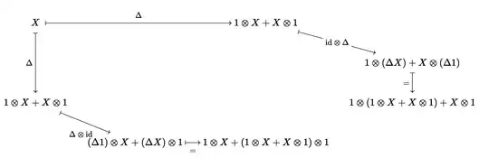

Then coassociativity tells us that if we apply $\Delta$ then we apply $\Delta$ again only to things on the left half of the $\otimes$, that's the same thing as applying $\Delta$ then applying $\Delta$ to the things on the right half of the $\otimes$. Explicitly:
I'll leave it to you to check that these last two terms really are equal, so that the diagram really does commute.
