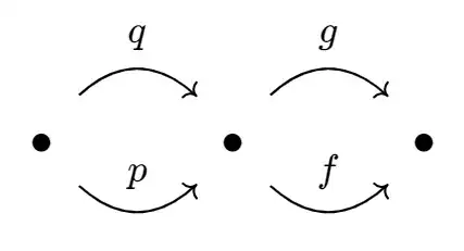

Consider the category generated by the following graph:
Just to make sure that we are on the same page, this category has 3 objects and 8 non-identity morphisms, namely $p, q, f, g, fp, fq, gp, gq$.
In this category, it is easy to verify that $p$ is not an equalizer, but it is vacuously a mono.
