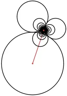

Draw circles of radius $1, \frac12, \frac13, ...$ such that the first two are externally tangent, then starting with the third, each circle is externally tangent to the previous two, with the path of the circle's centres turning in the same direction (clockwise say).
Let $d_n=$ distance between the first circle's centre and the $n$th circle's centre.
Is there a closed form for $L=\lim\limits_{n\to\infty}d_n$ ?
$L$ is the length of the red line segment below.
I superimposed cartesian axes and tried to express the coordinates of the $n^{\text{th}}$ circle's centre in terms of the coordinates of the previous two circles' centres, then take the limit as $n\to\infty$. But the algebra seems to be hopelessly complicated.
By manually drawing circles on desmos, it seems that $L\approx1.116$. Maybe $L=\frac{2}{\ln{6}}$ ?

    An interesting question, but I am skeptical about the idea that $L$ admits an elementary closed form. Just for reference, a numerical value of the limit is $$ L = 1.1147919825437510758\ldots, $$ which is accurate to within $10^{-20}$. Inverse symbolic calculators seem unable to find a closed form for this value. – Sangchul Lee Jan 21 '23 at 07:25
  • @Dstarred Using your method, I'm getting $x_C=4\sqrt{11}/99$ and $y_C=11/18$, which gives $L\approx0.626$, but I think that's way off. I think we have to consider more than just the first three circles. – Dan Jan 21 '23 at 08:11
