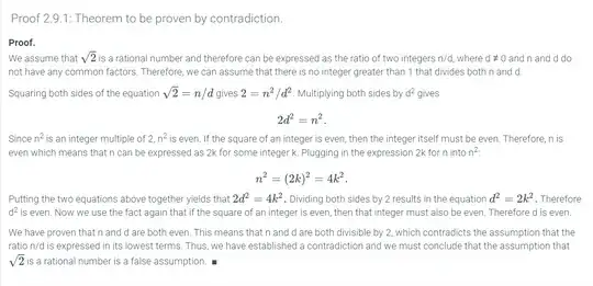

I am just learning about proofs in an introductory course. I came across an example of "proof by contradiction" (see attachment) about $ֿ\sqrt{2}$ being irrational. Some online sources have said that this is in fact a proof of negation. Is this correct? If so, how can you spot the difference between the two? Thank you.

    Is the same concept proof of negation and prove by contradiction. Two different names for the same type of logic prove structure when you negate the thesis to find a contradiction – giorgiokyn23 Jan 16 '23 at 10:33
  • "proof of negation" is not correct since we do not prove the negation. What is correct that we use the negation of the statement , we disprove it and establish that the negation cannot be true. This implies that the statement itself must be true. We could call it "prove by negation". – Peter Jan 16 '23 at 10:40
    According to the so-called "constructivistic" point of view, there is a difference between the two: in one case we start from an "affirmative" property and we conclude with its negation, in the other we assume a "negative" claim (there is no number such that...) and we conclude in the affermative. – Mauro ALLEGRANZA Jan 16 '23 at 10:43
    If so, the above proof is a "proof by negation" because the claim is: "there are two natural numbers $n,m$ such that $\sqrt 2 = \dfrac n m$". Having found a contradiction, the conclusion is: "there are no numbers..." that amounts to saying that $\sqrt 2$ is "not rational". – Mauro ALLEGRANZA Jan 16 '23 at 10:45

tl;dr The distinction is real. Nonetheless, you can safely call this a proof by contradiction in most introductory courses. Later on, in advanced and specialized courses, people might expect you to use more precise terminology, and distinguish between proofs of negation and proofs by contradiction.
Welcome to Math.SE!
I. To prove that the negation $\neg P$ of a proposition $P$ holds, we can use the following strategy: we tentatively assume that the proposition $P$ holds, and using this tentative assumption, we derive a contradiction.
For example, to prove that the negation of the proposition "there is a rational number $x$ such that $x^2 = 2$" holds, we tentatively assume that such an $x$ exists, and using this tentative assumption we show that there is an integer (the denominator of the same $x$, written in lowest terms) that is both even and odd, a contradiction.
Since assuming that "there is a rational number $x$ such that $x^2 = 2$" leads to a contradiction, we can conclude that the negation of this statement, "there is no rational number $x$ such that $x^2 = 2$" must in fact hold.
Common mathematical parlance calls this sort of reasoning a proof by contradiction (or reductio ad absurdum). It is perfectly appropriate to use the term "proof by contradiction" to refer to this sort of argument in an introductory course. Your instructors will understand what you mean.

A proof by contradiction is when you assume $\neg A$, derive a contradiction and conclude that $A$ holds.
A proof of negation is when you assume $A$, derive a contradiction, and conclude that $\neg A$ holds.
In classical mathematics, the difference is immaterial, as there is no distinction between $A$ and $\neg \neg A$. In constructive mathematics there is, however: For example, to prove that $\exists n \in \mathbb{N} \ P(n)$, you need to actually show the witness $n$. A proof of $\neg \neg \exists n \in \mathbb{N} \ P(n)$ includes no such information.
To see whether the proof of irrationality of $\sqrt{2}$ is a proof of negation or a proof of contradiction, we need to look at what "$x$ is rational" and "$x$ is irrational" mean. If $x$ is rational, we can provide concrete evidence by providing $n \in \mathbb{Z}$ and $m \in \mathbb{N}$ with $x = \frac{n}{m}$. But "$x$ is irrational" just means that $x$ is not rational.
Thus, proving that $\sqrt{2}$ is irrational is a proof of negation.
