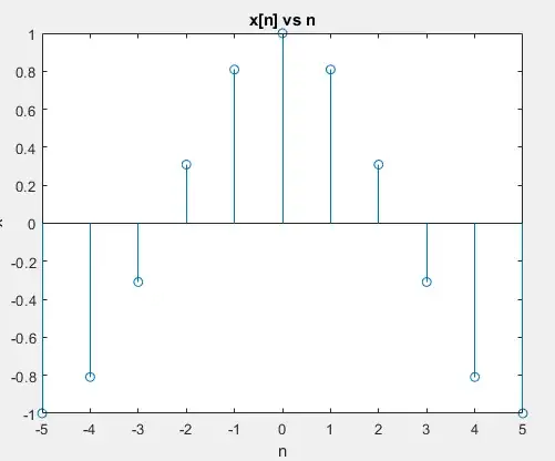

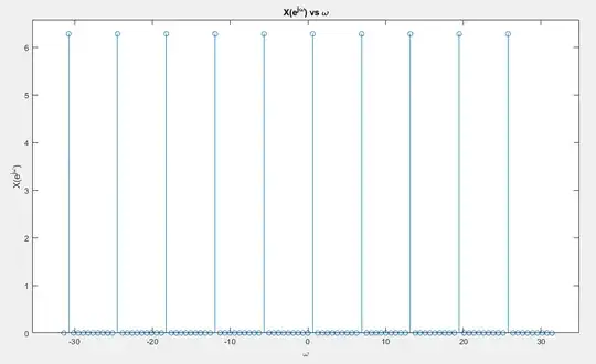

The following code was used to replicate the Fourier Transform representation of the function as an impulse train:
L = 5; len_ninf = 101;
n_inf = linspace(-L,L,len_ninf);
omega = 2*pi .* n_inf; omega_o = 2*pi/((length(n_inf)-1)/10);
x = exp(1j.*omega_o.*n_inf);
scatter(n,real(x)); stem(n,real(x));
l = -500:1:500;% some harmonic
impulsetrain = zeros(1,length(omega));
for i = 1:length(omega)
for j =1:length(l)
if round(((round(omega(i),2)- round(omega_o,2)) -2*round(pi,2)*l(j))/1000,4)==0
impulsetrain(i) = 2*pi*1;
end
end
end
scatter(omega,impulsetrain);
stem(omega,impulsetrain);
Where we can see each impulse at $\omega = \omega_0 +/- 2n\pi$
So we've created the impulse train (being a DTFT representation of x[n]) and a reference image of x[n]. Going back to the book showing that the IDTFT can be used to get back to original signal, according to the said source, x[n] was run through equation 1 to get:

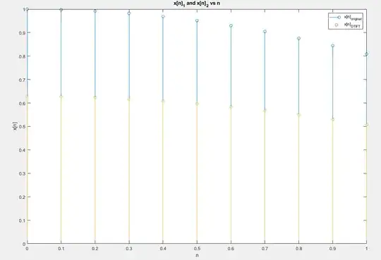

and that is exactly what I would like to show by running the impulse train through the IDTFT equation in equation 1, to prove this result. The following code below was used to do this:
del_omega = (omega(length(omega))-omega(1))/(length(omega)-1);
LeftBound = 0; RightBound = 2*pi + LeftBound; %Set Left bound to whatever multiple of del_omega you'd like
range = find(round(omega,2) == round(LeftBound,2)):find(round(omega,2) == round(RightBound,2));
x_dift = zeros(1,length(n_inf(range)));
for i = 1:length(n_inf(range))
x_dift(i) = 1/(2*pi) * trapz(omega(range),impulsetrain(range).*exp(1j*n_inf(range(i)).*omega(range))); % performs integration over range of 2 pi
end
scatter(n_inf(range),real(x(range)));stem(n_inf(range),real(x(range)));hold on
scatter(n_inf(range),real(x_dift));stem(n_inf(range),real(x_dift));xlabel('n');ylabel('x[n]');title('x[n]_1 and x[n]_2 vs n');legend x[n]_{original} x[n]_{DTIFT}
Doing a quick calculation just to verify the results from the for x[n] after the DTIFT, I got:
$x[0] = \frac{1}{2\pi} \int_0^{2\pi} \sum_{l=-\infty}^{l = +\infty}2\pi\delta{(\omega-\omega_0-2\pi l)}[range]*e^{j\omega * 0}d\omega = \int_0^{2\pi} [0,2\pi,0,0,0,0,0,0,0,0,0] * 1 d\omega$ with the $\omega$ values that we are integrating over are: $\omega = $[0,$\frac{\pi}{5}$,$\frac{2\pi}{5}$,$\frac{3\pi}{5}$,$\frac{4\pi}{5}$,$\pi$,$\frac{6\pi}{5}$,$\frac{7\pi}{5}$,$\frac{8\pi}{5}$,$\frac{9\pi}{5}$,$2\pi$] and where the bracketed list inside the equation above is the values of the impulse train over the range from 0 to $2\pi$.
and writing this computation using Matlab's build in Trapezoidal Rule algorithm we get:
Trapezoidal Rule: $\int_a^b f(x)dx \approx \frac{b-a}{2N} \sum^N_{n=1}(f(x_n) + f(x_{n+1}))$
where $\frac{b-a}{2N}$ is 1/2 spacing between each point. In our case, this constant is $\frac{2\pi - 0}{2*(11-1)} = \frac{\pi}{10}$.
$x[0] =\frac{1}{2\pi}*\frac{\pi}{10}(((0*1) + (2\pi*1)) + ((2\pi*1) + (0*1)) + 0 + 0 + 0 + 0 + 0 + 0 + 0) = \frac{4\pi^2}{10\pi} = \frac{\pi}{5} = .628$
This matches up with the first result seen in the plot at the first indice. Any further sample calculations would be a replication of the first computation seen above, but with the exponential which the impulsetrain values are being multiplied by would no longer be 1, and instead be relatively close to, and smaller than 1 and also decay at a slow rate as the index, n, increases which would replicate the results seen in the plot.
Overall, we can see that the resulting values from the IDTFT in orange are under where they are supposed to be and I've verified the results, so unless there is some special step that needs to be performed for certain signals like this impulse train, I'm not sure what it is that went wrong. Just out of curiosity, I tried increasing the number of values inside the range of the interval of $2\pi$ by reducing the $\Delta\omega$ because, from experience, the more values being input for a Fourier Transform, the more accurate the results, but it didn't work in this Discrete Time example like it did with Continuous Time Fourier Transforms and its inverse counterpart. In fact, the values actually decreased by a factor equal to the factor that I increased the number of values by. Specifically, I went from having 101 omegas to 1001 omegas, and the results were the exact same but divided by 10 i.e. the value at x[0] went from $\frac{\pi}{5}$ to $\frac{\pi}{50}$ and so on. I'd like to know why I am unable to get to the same amplitude using the methodology laid out in the textbook, but am at a loss.

![plot of x[n] original in blue vs x[n]_IDTFT in orange](../../images/f73ee2f5771d8590a10165b2aaca9319.webp)
