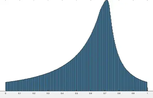

This is similar to a continued fraction that acts as a transformation on a random variate of a distribution. From prior work and from numerical simulations, we observe that the distribution settles down into a stationary form after successive iterations. Reasonable approximations to the stationary distribution are reached after about 4 to 5 iterations already. Below is a visualization of the distribution:

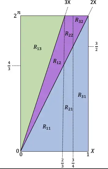

We can determine that the range of the transformation is $[0,1]$. The next step is to determine which values of $n$ and $X$ can map to which regions within the n-by-X or 2-by-1 region. The graph below is partitioned into "Regions". These Regions are marked as $R_{st}$, where $s$ marks the region where $X_j$ belongs and $t$ marks the region where $X_{j+1}$ belongs.
By inspecting the 2-by-1 grid, we can divide the region into 7 distinct regions. Those regions in the blue map to the $\left[0,\frac{2}{3}\right]$ region, the region in green maps to the $\left[\frac{3}{4},1\right]$ region, and finally, those regions in the purple map to the $\left[\frac{2}{3},\frac{3}{4}\right]$ region on the $[0,1]$ number line.
Phase Transition Diagram
To determine how much of each region distribution contributes to the total probability, we need to find the limiting distributions of the transition probabilities. We can understand this as a Markov process where the transition probabilities are the individual areas. Calculating these we get the transition matrix, $\mathbf{T}$ as follows:
\begin{equation} \mathbf{T} = \begin{bmatrix}\frac{4}{9}&\frac{2}{9}&\frac{1}{3}\\\frac{17}{24}&\frac{7}{24}&0\\\frac{7}{8}&\frac{1}{8}&0\end{bmatrix} \end{equation}
The limiting distribution of $R_1$, $R_2$, and $R_3$, can be found easily then as $\frac{17}{29}$, $\frac{19}{87}$, and $\frac{17}{87}$, respectively.

Current Challenge: Region 2
The region $\left[\frac{2}{3},\frac{3}{4}\right]$ presents an additional difficulty as it seems that its distribution is the aggregation of regions 1 and 3. It is not clear to me how to determine $p_2(x)$ and it is here where I would appreciate some insight and perhaps assistance.
I would expect that we should be able to complete a similar transformation using $p_1(x)$ and $p_3(x)$. I would expect that $p_2(x)$ should be the aggregate distribution of the following:
  1. Using $p_1(x)$ and the transformation where $n \sim U(2X,3X)$
  2. Using $p_3(x)$ and the transformation where $n \sim U(2X,2)$
It seems reasonable but it does not seem to work out.
