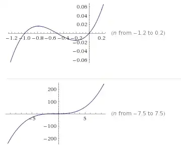

If I make a geometric interpretation of the problem. Plotting the right side of (a). $f(x)= \frac{n(n+1)(2n+1)}6$
graphic interpretation of f(x) on (a)
We can see that (a) is a CONTINUOUS FUNCTION.

Is it valid to say that if a function is a "continuos function" is the same as making the math induction of the validity of (a) for any number k=n+1?
No, simply saying that this is a continuous function does not work as an induction step.
The function $f(n) = n$ is continuous, but it is certainly not true that
$$\sum\limits_{i = 1}^n i^2 = n.$$
