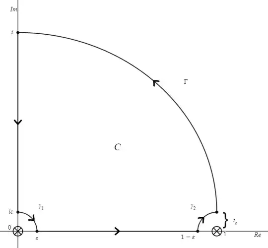

Proof. Let $f(z) = \ln\left(\ln\left(\dfrac{1}{z}\right)\right)$ where $\operatorname{arg}(z) \in (-\pi, \pi]$. Define a contour $C = [\epsilon,1-\epsilon] \cup \gamma_2 \cup \Gamma \cup [i,i\epsilon] \cup \gamma_1$ for small $\epsilon > 0$ that we will traverse counterclockwise around. A visual is provided below, and its Desmos code can be viewed here made by one of my friends.
By Cauchy's Residue Theorem, we write $\displaystyle\oint_C f(z)dz$ as
$$ \eqalign{ 0 &= \int_{\epsilon}^{1-\epsilon}f(z)dz + \int_{\gamma_2} f(z)dz + \int_{\Gamma} f(z)dz +\int_{i}^{i\epsilon} f(z)dz + \int_{\gamma_1} f(z)dz \cr \operatorname{P.V.}\int_0^1 f(z)dz &= \lim_{\epsilon \to 0}\left(\int_{-\gamma_1} f(z)dz + \int_{-\gamma_2} f(z)dz + \int_{i\epsilon}^{i} f(z)dz - \int_{\Gamma} f(z)dz\right). } $$
Both $\displaystyle\int_{-\gamma_1} f(z)dz$ and $\displaystyle\int_{-\gamma_2} f(z)dz$ approach $0$ as $\epsilon \to 0$ using similar methods. To demonstrate,
$$ \eqalign{ \lim_{\epsilon \to 0}\int_{-\gamma_1}f(z)dz &= \lim_{\epsilon \to 0}\int_{0}^{\pi/2}f\left(\epsilon e^{i\theta}d\epsilon e^{i\theta}\right) \cr &= i\int_{0}^{\pi/2}e^{i\theta}\lim_{\epsilon \to 0}\epsilon \ln\left(\ln\left(\frac{1}{\epsilon e^{i\theta}}\right)\right)d\theta \cr &= i\int_{0}^{\pi/2}e^{i\theta}\lim_{\epsilon \to 0} \frac{\ln\left(-\ln\left(\epsilon e^{i\theta}\right)\right)}{1/\epsilon}d\theta \cr &= i\int_{0}^{\pi/2}e^{i\theta}\lim_{\epsilon \to 0} \frac{\frac{d}{d\epsilon}\ln\left(-\ln\left(\epsilon e^{i\theta}\right)\right)}{\frac{d}{d\epsilon}1/\epsilon}d\theta \cr &= i\int_{0}^{\pi/2}e^{i\theta}(0)d\theta \cr &= 0. } $$ We can apply a similar procedure for $\displaystyle\int_{-\gamma_2} f(z)dz$, albeit a bit more grunt work. We would have to parameterize $z=1+\epsilon e^{i\theta}$ for $\theta \in [\pi/2, \pi]$.
For $\displaystyle \int_{\Gamma} f(z)dz$, let $z = e^{it}$ such that $t \in [t_{\epsilon}, \pi/2]$. Note that $t_{\epsilon} > 0$ is small and accounts for the tiny gap near $z=1$. Then
$$ \eqalign{ \int_{t_{\epsilon}}^{\pi/2}f\left(e^{it}\right)de^{it} &= i\int_{t_{\epsilon}}^{\pi/2} \ln\left(-\ln\left(e^{it}\right)\right)e^{it}dt \cr &= i\int_{t_{\epsilon}}^{\pi/2}\ln\left(-it\right)e^{it}dt \cr &= i\int_{t_{\epsilon}}^{\pi/2} e^{it}\left(\ln\left|-it\right|+i\operatorname{arg}\left(-it\right)\right)dt \cr &= i\int_{t_{\epsilon}}^{\pi/2} e^{it}\left(\ln\left(t\right)-\frac{i\pi}{2}\right)dt \cr &= i\Big[i\operatorname{Ei}(it)-ie^{it}\ln(t)\Big]_{t_{\epsilon}}^{\pi/2} + \frac{\pi}{2}+\frac{i\pi}{2} \cr &\to \gamma + \frac{\pi}{2}+i\pi+i\ln\left(\frac{\pi}{2}\right)- \operatorname{li}(i) } $$ as $t_{\epsilon} \to 0$, where we used the definitions of the Exponential Integral and the Logarithmic Integral.
We evaluate $\displaystyle \int_{i\epsilon}^{i} f(z)dz$ as follows:
$$ \eqalign{ \int_{i\epsilon}^{i} \ln\left(-\ln\left(z\right)\right)dz &= \int_{\epsilon}^{1} \ln\left(-\ln\left(iy\right)\right)diy \cr &= i\Big[y\ln\left(-\ln\left(iy\right)\right)\Big]_{\epsilon}^{1} - i\int_{\epsilon}^{1}\frac{dy}{\ln\left(iy\right)} \cr &= i\left(\ln\left(-\ln\left(i\right)\right)-\epsilon\ln\left(-\ln\left(i\epsilon\right)\right)\right) - i\Big[-i\operatorname{li}(iy)\Big]_{\epsilon}^{1} \cr &\to \frac{\pi}{2}+i\pi+i\ln\left(\frac{\pi}{2}\right)- \operatorname{li}(i) } $$ as $\epsilon \to 0$.
Going back to $\displaystyle \oint_C f(z)dz$, we collect our results:
$$ \eqalign{ \operatorname{P.V.}\int_0^1 f(z)dz &= 0 + 0 + \left(\frac{\pi}{2}+i\pi+i\ln\left(\frac{\pi}{2}\right)- \operatorname{li}(i)\right) - \left(\gamma + \frac{\pi}{2}+i\pi+i\ln\left(\frac{\pi}{2}\right)- \operatorname{li}(i)\right) \cr &= -\gamma. \cr } $$
In conclusion,
$$\int_{0}^{1}\ln\left(\ln\left(\frac{1}{x}\right)\right)dx = -\gamma.$$
Q.E.D.

    I didn't expect a Complex Analysis proof! But I won't accept this yet since I would like to see other proofs. I did upvote though :) – Kamal Saleh Jan 04 '23 at 17:16
    Thank you! You don't have to accept it if you don't want to. I don't care that much about points. All I care about is getting my ideas out there. @KamalSaleh – Accelerator Jan 04 '23 at 22:31
    So you won't care to get +15 points? ;) I just realized how much effort you and your friend had on not just the derivation but the graph too. – Kamal Saleh Jan 05 '23 at 05:07
    My friend was the one who made the graph on Desmos, and it was for two American Mathematical Monthly problems that involved Apery's Constant. That contour, coincidentally, was also useful for this problem. I don't think she ever knew how the contour worked mathematically, so it was just me making up the proofs. @KamalSaleh – Accelerator Jan 05 '23 at 05:12
