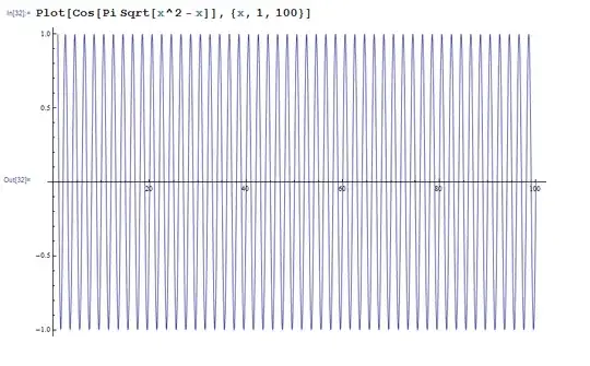

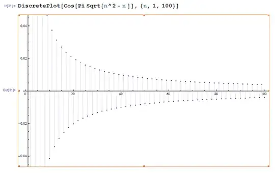

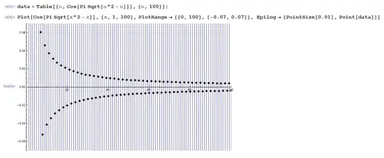

The behavior of the sequence $$ \{\cos(\pi \sqrt{n^2-n})\}_{n=1}^\infty $$ and that of the function $$ \cos(\pi \sqrt{x^2-x}) $$ are very different, which has been pointed out by other answers and comments.
I would like to just add three pictures created with Mathematica to illustrate this point here: enter image description here
