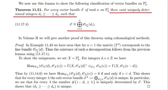

I'm reading the Gortz's Algebraic Geometry, proof of the Theorem 11.51 and stuck at understanding existence part :

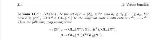

We will use the his book, Lemma 11.50 :
Here, $R^{+} := k[T], R^{-}:=k[T^{-1}], R^{\pm}:=k[T,T^{-1}]$.

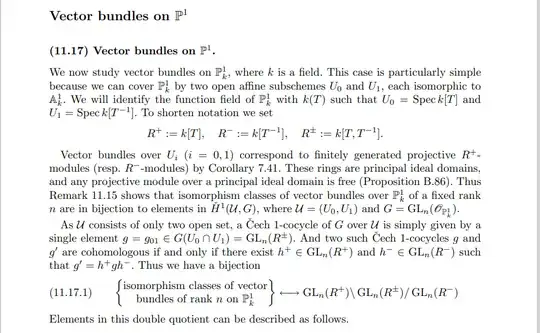

Note that in his book, p.313, (11.17.1) there is a bijection.
$$A:= \{ \operatorname{isomorphism classes of vector bundles of rank n on} \mathbb{P}_k^{1} \} \xrightarrow{\psi} B:=GL_{n}(R^{+}) \backslash GL_{n}(R^{\pm})/GL_n(R^{-1})$$ (double quotient)
C.f. p.313 is as follows :
Now, to show the underlined statement, fix a vector bundle $\mathcal{E}$ of rank $n$ on $\mathbb{P}_k^{1}$. By the above Lemma 11.50, there exists a $\mathbf{d}:=(d_1 \ge d_2 \ge \cdots \ge d_n) \in (\mathbb{Z}^{n})_{+}$ such that $\psi(\mathcal{E})=GL_n(R^{+})T^{\mathbf{d}}GL_n(R^{-1})$.
Let $X:= \mathbb{P}_k^{1}$ and $G:=GL_n(\mathcal{O}_X) : U \mapsto \operatorname{Aut}_{\mathcal{O}_U}(\mathcal{O}_X^{n}|_U) = GL_n(\Gamma(U,\mathcal{O}_U))$. Note that $\mathcal{U}:=(U_0, U_1)$, where $U_0:=\operatorname{Spec}k[T]$, $U_1:=\operatorname{Spec}k[T^{-1}]$, is an affine open cover of $X$ ( c.f. Gortz's Book, p.313 )
Q. Then $\psi ( \bigoplus_{i=1}^{n} \mathcal{O}_{X}(d_i)) = GL_n(R^{+})T^{\mathbf{d}}GL_n(R^{-1})$ ? If so, then $\psi(\mathcal{E}) = \psi ( \bigoplus_{i=1}^{n} \mathcal{O}_{X}(d_i))$ and $ \mathcal{E} \cong \bigoplus_{i=1}^{n} \mathcal{O}_{X}(d_i)$.
To show this question, I think that we can describe the above map $\psi$ more in detail.
First, let $A_{\mathcal{U}}:= \{\operatorname{isomorphism classes of locally free} \mathcal{O}_X-\operatorname{modules} \mathcal{E} \operatorname{of rank n such that} \mathcal{E}|_{U_i} \cong \mathcal{O}_{U_i}^{n} \operatorname{for all} i=0,1 \}$
Then $A = A_{\mathcal{U}}$ as in his book, p.313, (11.17) (True?).
Then I think that the $\psi$ is as follows :
$$ \psi : A=A_{\mathcal{U}} \to H^{1}(\mathcal{U},G) \xrightarrow{c_{G,\mathcal{U}}} \check{H}^{1}(\mathcal{U},G) \to B:=GL_{n}(R^{+}) \backslash GL_{n}(R^{\pm})/GL_n(R^{-1}) $$
Here, $H^{1}(\mathcal{U},G) := \{T\in H^{1}(X,G) : T \operatorname{is trivialized by} \mathcal{U} ; i.e., T(U_i) \neq \emptyset \operatorname{for all} i \}$ (Here $H^{1}(X,G)$ is the set of isomorphism classes of $G$-torsors (c.f. his book p.292)). And the first map is $\mathcal{G} \mapsto \mathcal{Isom}(\mathcal{O}_X^{n},\mathcal{G})$ (c.f. his book p.295, (11.6)). And the second map $c_{G,\mathcal{U}}$ is in p.294 above. And the third map is as p.313 (above image).
