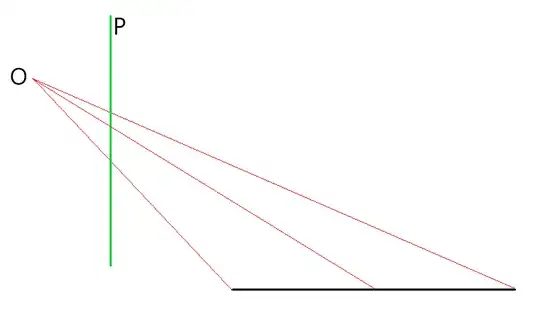

This is explained without words in the following schematic where the bottom black line segment is the circle lying horizontally, and projection plane is shown in green. Point O is where all the rays converge. It can be seen that the projection of the center of the circle is not halfway between the two extremities of the projection of the circle.
Must be for the same reason in the circle placed inside the square. – kirismasdada Dec 25 '22 at 11:03
