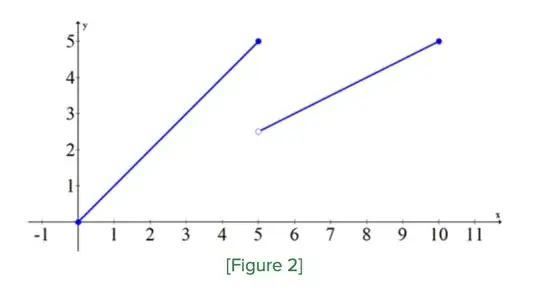

In that case, how about the following function?
If this function is not a counterexample for the converse of the IVT, why is that? Does a function have to have the IVP on every possible open interval in the domain to be considered as a counterexample for the converse of the IVT? That is what I am guessing because I see functions like $f(x)=\sin(1/x)$ for $x\neq 0$ and $f(0)=0$ being used as a counterexample, whose discontinuity at $x=0$ is not a simple discontinuity.

A real valued function has the “intermediate value property” if
... for any two values $a$ and $b$ in the domain of $f$, and any $y$ between $f(a)$ and $f(b)$, there is some $c$ between $a$ and $b$ with $f(c) = y$.
With that definition, your function in Figure 2 does not have the intermediate property, it fails e.g. for $(a, b) = (4.5, 5.5)$.

For the latter, assume that $f$ is discontinuous at $x=a$, and has both a right limit $r$ and a left limit $l$ at $x=a$. Then the three numbers $f(a), l, r$ are not all identical (otherwise $f$ were continuous at that point). In a sufficiently small interval $J = (a-\epsilon, a+\epsilon)$ takes $f$ only values close to $l$, $r$, and $f(a)$, so that $f(J)$ is not an interval. It follows that $f$ does not have the intermediate value property.

  • I see. So when people look for a counterexample of the IVT, they look for a function $f$ which assumes every value between $f(a)$ and $f(b)$ for ANY $a,b$ in the domain of $f$, not just the endpoints of the domain. It was not clear from Rudin's presentation of the IVT which says that a continuous function $f:[a,b]\to\mathbb{R}$ assumes every value between $f(a)$ and $f(b)$. I thought the function in the figure assumes every value between $f(0)$ and $f(10)$, but has a simple discontinuity, so it is weird. – Kohei M. Dec 20 '22 at 16:57
