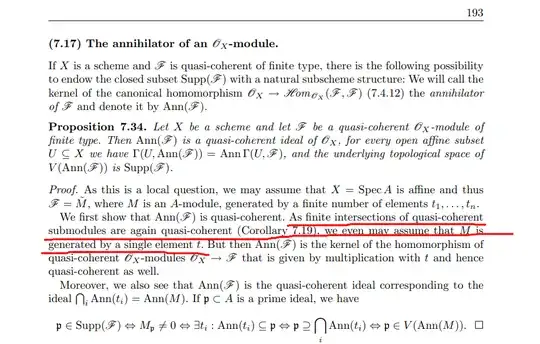

I’m reading Görtz–Wedhorn’s Algebraic Geometry, proof of the Proposition 7.34, and some question arises.
Let $X$ be a scheme and $\mathcal{F}$ a quasi-coherent module of finite type. Define the annihilator $\newcommand{\Ann}{\operatorname{Ann}} \Ann \mathcal{F}$ of $\mathcal{F}$ as the kernel of the canonical homomorphism $\newcommand{\OX}{\mathcal{O}_X}\OX \to \mathcal{H}\mathrm{om}_{\OX}(\mathcal{F}, \mathcal{F})$ (Görtz–Wedhorn, 7.2.12, page 193). By Annihilator of a coherent sheaf, on affine subsets., for each open subset $U$ of $X$, $$ \Ann(\mathcal{F})(U) := \{f \in \OX(U) \mid \forall x \in U, \forall m_x ∈ F_x, f_x \cdot m_x=0\} \,. $$

C.f. This question originates from following proof of the Görtz–Wedhorn, Proposition 7.24: enter image description here Why is the underlined statement true? If our question is true, then since finite intersections of quasi-coherent submodules is again quasi-coherent, is suffices to show that each $\Ann \tilde{M_i}$ is quasi-coherent; i.e., we may assume that $M$ is generated by single element.
