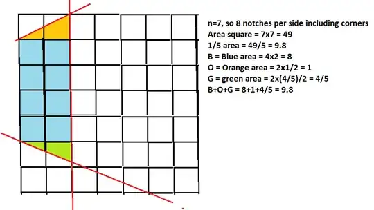

It is also possible with $n=7$ using three cuts. enter image description here

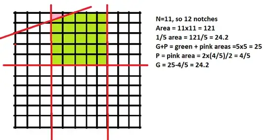

and also possible for $n=11$. enter image description here
My hypothesis is that it is possible for any $n.$
