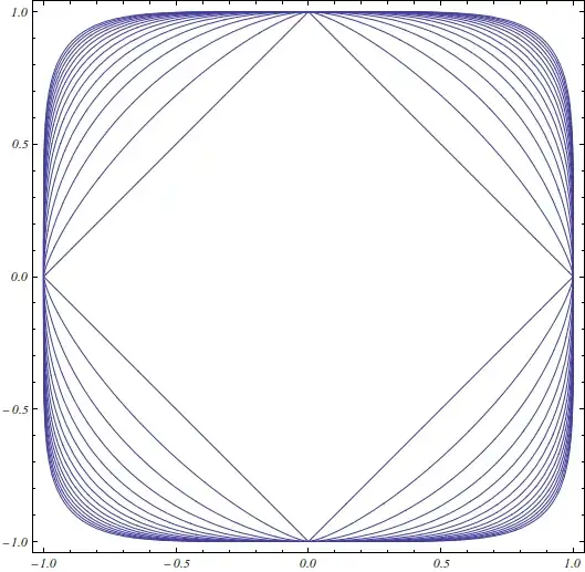

Some beautiful supercircles are shown in the image bellow:
supercircles beautiful supercircles
As one can see their limiting case is a square.
