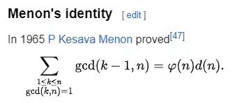

To go further Cauchy's induction ? or from wikipedia source :
Menon
To be continued...
