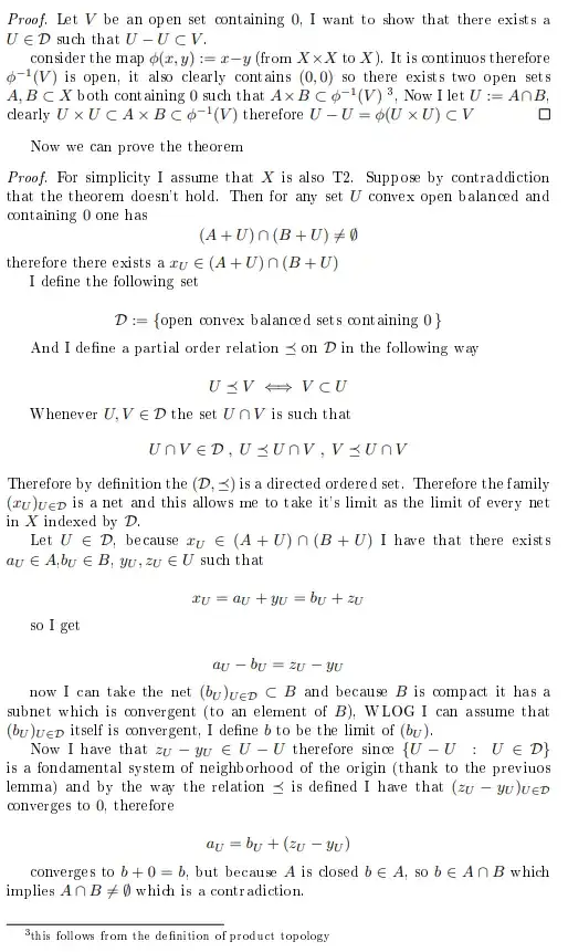

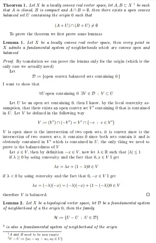

I tried to generalize this proof to the general case, this is what I came up with :
Part 1 of the proof
Part 2 of the proof
Is the proof actually correct? If it is, can it be generalized to the case where $X$ is not $T2$?If it's not, why? and is there a way to "fix" the mistakes in the proof?

    I find this proof correct. More generally (Bourbaki, General Topology, chap. II, § 4.3) in a uniform space $X$, for disjoints subsets $A$ compact and $B$ closed, there exists an entourage $V$ such that $V(A)\cap V(B)=\varnothing.$ Your Theorem 1 then results from your Lemma 1, without assuming $X$ is T2. Lemma 1 is immediate with the definition of locally convex t.v.s. by semi-norms. – Anne Bauval Oct 28 '22 at 23:07
  • @AnneBauval the thing I'm not sure about is if I can say that the net $(b_U)_{U \in \mathcal{D}}$ has a converging subnet and if the limit of that subnet is in $B$. This would clearly be true when $X$ has a norm because in that case compact $\implies$ sequentally compact and closed, but since $X$ doesn't have a norm is this true? – Paul Oct 29 '22 at 09:30
    For every topological space $B$ (even not T2), convergence (to a point in $B$) of some subnet for every net is equivalent to compactness of $B.$ (Hence different from sequential compactness: neither stronger nor weaker. Except of course if $B$ is metrizable.) – Anne Bauval Oct 29 '22 at 10:35

  • @AnneBauval but a sequence is also a net so this would imply that every compact is also sequentually compact. Where am I wrong? – Paul Oct 30 '22 at 10:53
