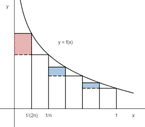

If we assume that $f(x)$ is decreasing, here is an argument that $L=\lim\limits_{n\to\infty}\sum\limits_{k=1}^n f\left(\frac{k}{n}\right)$ does not exist.
The graph shows an example with $n=3$. (The curve does not have to be above the x-axis.)
$\begin{align} \frac{1}{2n}\sum\limits_{k=1}^{2n}f\left(\frac{k}{2n}\right) & =\frac{1}{n}\sum\limits_{k=1}^{n}f\left(\frac{k}{n}\right)+\color{red}{(\text{area of red region})}+\color{blue}{(\text{total area of blue regions})}\\ & =\frac{1}{n}\sum\limits_{k=1}^{n}f\left(\frac{k}{n}\right)+\color{red}{\frac{1}{2n}\left(f\left(\frac{1}{2n}\right)-f\left(\frac{1}{n}\right)\right)}+\color{blue}{\frac{1}{2n}\left(\frac{1}{2}\left(f\left(\frac{1}{n}\right)-f(1)\right)\right)+O\left(\frac{1}{n}\right)} \end{align}$
Multiply by $2n$ and rearrange.
$2\sum\limits_{k=1}^{n}f\left(\frac{k}{n}\right) - \sum\limits_{k=1}^{2n}f\left(\frac{k}{2n}\right) =\color{brown}{\frac{1}{2}f\left(\frac{1}{n}\right) - f\left(\frac{1}{2n}\right)}+\frac{1}{2}f(1)+c+O\left(\frac{1}{n^2}\right)$
$f(x)\to\infty$ as $x\to0^+ \implies \color{brown}{\frac{1}{2}f\left(\frac{1}{n}\right) - f\left(\frac{1}{2n}\right)} \le -\frac{1}{2}f\left(\frac{1}{2n}\right)$
$\therefore 2\sum\limits_{k=1}^{n}f\left(\frac{k}{n}\right) - \sum\limits_{k=1}^{2n}f\left(\frac{k}{2n}\right) \le -\frac{1}{2}f\left(\frac{1}{2n}\right)+\frac{1}{2}f(1)+c+O\left(\frac{1}{n^2}\right)$
If $L=\lim\limits_{n\to\infty}\sum\limits_{k=1}^n f\left(\frac{k}{n}\right)$ exists, then as $n\to\infty$, LHS $\to L$ but RHS $\to-\infty$. Contradiction.
$\therefore L$ does not exist.
