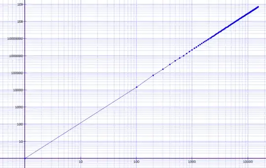

Let $P(n)$ be the period of the decimal expansion of $1/n$, for prime $n$ (e.g. $1/7=0.\overline{142857}\rightarrow P(7)=6$). The value of $P(n)$ fluctuates heavily, but it seems to have an average behavior that is more easily visible by considering the function $$S(x)=\sum_{k=1}^{x}P(p_k)$$ Where $p_k$ is the kth prime. Below is the graph of $S(x)$. enter image description here
A power regression gives the following approximation with an $R^2$ of $0.9998753$ $$S(x)\approx0.94782x^{2.11976}$$ which would imply that the average value/approximation of $P(p_n)$ around $p_n$ is $$P(p_n)\approx 0.94782(n^{2.11976}-(n-1)^{2.11976})$$ Is there a way to derive this behavior other than empirically?
