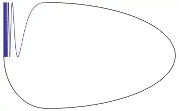

A connected subset of a manifold need not be a topological manifold. For instance, the top left corner point of the Warsaw circle does not have any connected neighbourhood (in the subspace topology).
The Warsaw circle
It follows that the Warsaw circle isn't locally euclidean, although it is a (closed, even compact) subspace of $\Bbb R^2$.
