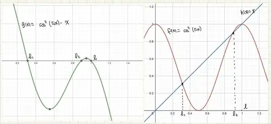

First of all, for a fixed $x_0\in\mathbb R$, if $f^n(x_0)$ is convergent, then its limit $\ell$ must be a fixed point of $f$. Since $f(x)=\cos^2(\pi x)\in[0,1]$, we must have $\ell\in[0,1]$. Let's find the fixed points of $f$. Let $g(x)=f(x)-x$ for $x\in[0,1]$, then we need to find the zeroes of $g$. Since $g'(x)=-\pi\sin(2\pi x)-1$, $g'$ has two zeroes $\eta_1,\eta_2\in[0,1]$ with $1/2<\eta_1<3/4$, $3/4<\eta_2<1$, and $\sin(2\pi\eta_1)=\sin(2\pi\eta_2)=-1/\pi$. Hence, $g$ is decreasing in $[0, \eta_1)$, then increasing in $(\eta_1, \eta_2)$, and then decreasing in $(\eta_2,1]$. Note that $g(1/2)=-1/2<0, g(1)=0$, we know that $g(\eta_1)<0$ and $g(\eta_2)>0$. Therefore, we can find three zeroes of $g$, named by $\ell_1$, $\ell_2$ and $\ell$ with $\ell_1\in(0,1/2)$, $\ell_2\in(\eta_1, \eta_2)$ and $\ell=1$.
The graphs
We can find the locations the fixed points $\ell_1, \ell_2$ more accurately. Indeed, since $$g\left(\frac14\right)=\cos^2\left(\frac\pi4\right)-\frac14=\frac12-\frac14>0,\qquad g\left(\frac13\right)=\cos^2\left(\frac\pi3\right)-\frac13=\frac14-\frac13<0,$$ we have $\ell_1\in(1/4,1/3)$, hence $$f'(\ell_1)=-\pi\sin(2\pi\ell_1)<-\pi\sin\left(\frac{2\pi}3\right)=-\frac{\sqrt 3}2\pi<-1.$$ Also, $$g\left(\frac56\right)=\cos^2\left(\frac56\pi\right)-\frac56=\frac34-\frac56<0,\qquad g\left(\frac{11}{12}\right)=\frac{1+\cos\left(\frac{11}6\pi\right)}2-\frac{11}{12}=\frac{\sqrt3-2}4>0,$$ we have $\ell_2\in(5/6,11/12)$, hence $$f'(\ell_2)=-\pi\sin(2\pi\ell_2)>-\pi\sin\left(\frac{11\pi}6\right)=\frac{1}2\pi>1.$$
The following are not rigorous.
Therefore, locally, near $\ell_1$, $f$ behaves like $-A(x-\ell_1)$ with $A>1$. Consider the map $f_1: x\mapsto -Ax$, then $f_1^n(x)$ converges if and only if $x=0$. This indicates that, for fixed $x_0$, if the sequence $\{f^n(x_0)\}$ doesn't reach $\ell_1$, it will not converge to $\ell_1$ ; a similar analysis on $\ell_2$ indicates that $\{f^n(x_0)\}$ will not converge to $\ell_2$ if it doesn't touch $\ell_2$; hence, if $\{f^n(x_0)\}$ converges without touching $\ell_1, \ell_2$, then the limit should must be $\ell=1$. I think the ideas in this paragraph can be written down rigorously, although I don't know how to write a clean one.
