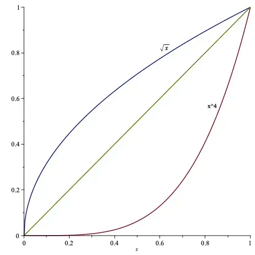

$f(x)=\sqrt{x}$, $g(x)=x^4$, $f(g(x))=g(f(x))=x^2$
Here we have a case of (3a)

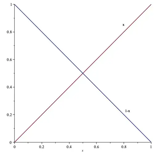

$f(x)=x$, $g(x)=1-x$, $f(g(x))=g(f(x))=1-x$

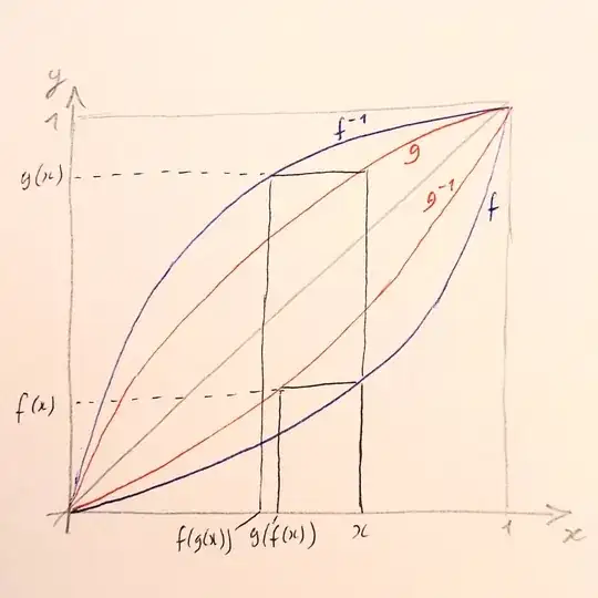

Here is a graphical interpretation. Sorry for the manual drawing.
Draw the graphs of $f, g, f^{-1}, g^{-1}$. For simplicity of drawing I assume $f$ and $g$ to be $[0,1] \to [0,1]$. $f^{-1}$ and $g^{-1}$ are symmetrics of $f$ and $g$ by the first diagonal.
Then $f(g(x))$ and $g(f(x))$ are constructed as follows:
example drawing
$f$ and $g$ commute if $f(g(x))$ and $g(f(x))$ reach the same abscissa; which is almost but not quite the case on the drawing.
In addition, because this is true $\forall x$, there is a relation between the slopes of 4 points in the diagram: the slope of $f$ on abscissa $x$ divided by the slope of $g^{-1}$ on abscissa $g(f(x))$ equals the slope of $g$ on abscissa $x$ divided by the slope of $f^{-1}$ on abscissa $f(g(x))$. Which is in fact the differentiation of $f(g(x))=g(f(x))$:
$g'(x)f'(g(x))=f'(x)g'(f(x))$
$g'(x)/(f^{-1})'(f(g(x))=f'(x)/(g^{-1})'(g(f(x))$
