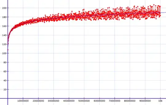

I was playing with the Collatz conjecture and decided to check it for the first 100,000,000 natural numbers. I divided this range in equal intervals of 100,000 and calculated the average number of steps to reach 1 in each one of these intervals. By graphing these averages, I got the following result enter image description here
Which seems to show a very clear logarithmic behavior. By doing a least squares regression (shown in blue), I derived that the average number of steps ($S$) for a number $n$ to reach 1 is $$S\approx10.45\ln(n)-3$$ Is there a way to derive this logarithmic relation?

    Each odd integer in a Collatz sequence is on average ~3/4 of the previous odd integer using a probabilistic argument. Going from one odd integer to the next takes 3 steps on average (1 multiply add, 2 divides) so the average number of steps to get to 1 starting with an odd integer should be about -3ln(n)/ln(3/4)) ~ 10.428ln(n). – Eric Shumard Oct 16 '22 at 17:21
    I wanted reproduce your statistics, but did not know, what you were counting. Odd steps - (type: $3x+1$or type $(3x+1)/2$ ) ? Even steps ? their sum? please insert a statement in your question. Moreover, a logarithmic scale for x-axis gave a better (?) pattern. Even more, if I used the logarithm of the meanvalue-of-category instead of the lower bound of the category this seemed to come out better... – Gottfried Helms Oct 16 '22 at 18:48
The function $S(n)$ can have its value estimated by considering the expected value $s(n)$, which corresponds to the average number of steps near $n$. For some "random" $n$, there is a $1/2$ probability that it is even or odd, therefore, $$s(n)=\frac{1}{2}\left(1+s\left(\frac{n}{2}\right)\right)+\frac{1}{2}\left(2+s\left(\frac{3n+1}{2}\right)\right)$$ If $s(n)=b\ln(n)$, then $$b\ln(n)=\frac{1}{2}\left(1+b\ln\left(\frac{n}{2}\right)\right)+\frac{1}{2}\left(2+b\ln\left(\frac{3n+1}{2}\right)\right)$$ Solving for $b$, $$b=\frac{3}{\ln\left(\frac{4}{3+1/n}\right)}$$ which, for $n\rightarrow \infty$, $$b=\frac{3}{\ln\left(4/3\right)}\approx10.43$$ Which matches the value found by the regression.

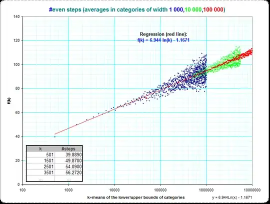

As @Peter already observed, the fluctuations are heavy. So I tried to reproduce your statistic, hoping that the $S=$ number-of-even-steps in the transformation rule "$T(x):$ $3x+1$ when $x$ is odd, $x/2$ when $x$ is even" is what you've evaluated.
I only could go up to $10 \; 000 \; 000$ values at all, so I show the scattering in bins of size=1000 (blue), size=10000 (green), size=100000 (red). (The trendline is in red, based only on the 1000-size bins).
Different from your picture I scale the x-axis logarithmically and get a near linear trend. However, the fluctuations increase with the index of the bins - independently, how large the bins are: an interesting observation on its own.

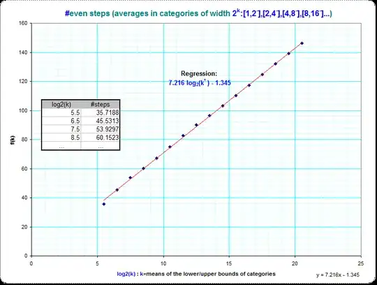

After the fluctuations increase with the index-number of the bins, I think, a variable/an increasing binsize might be appropriate. Here I show the average number of even steps, when the size of bins are doubled with the index. Moreover, I took as x-coordinate the geometric mean value of the bin-bounds. See this:
Here we get a nice nearly linear trend. The slope $7.216$ divided by $\ln(2)$ gives about $10.4104$ which agrees roughly with the slope that has been found in the OP.
Again: the increasing fluctuations over the bins of equal size seem a remarkable effect to me.
