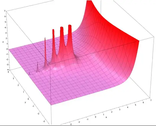

The real part of $\Gamma$
real part

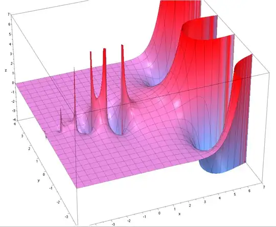

The imaginary part of $\Gamma$ imaginary part

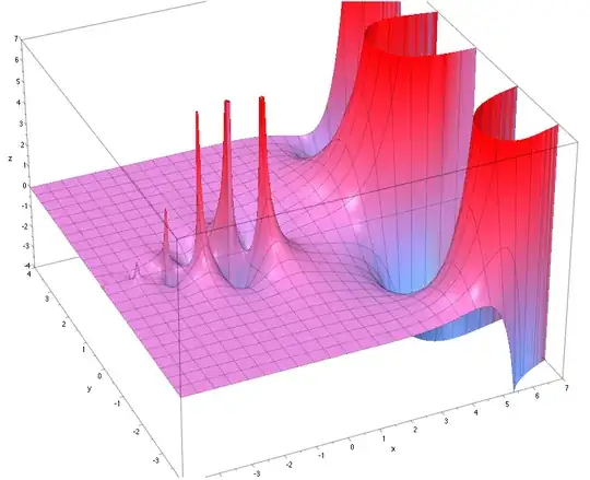

The modulus of $\Gamma$ (note the regularity of the surface at the right of the pole at $0$)
abs gamma
