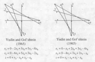

The paper "Visualizing and Constructing Cycles in the Simplex Method" by David Avis, Bohdan Kaluzny and David Titley-Péloquin has an image snipit from Yudin and Gol'shtein's book that also shows these models:
Model one from image: $$z = x_3-x_4+x_5-x_6$$ Subject to: $$x_1+2x_3-3x_4-5x_5+6x_6=0$$ $$x_2+6x_3-5x_4-3x_5+2x_6=0$$
Model two from image: $$z = x_3-x_4+x_5-x_6$$ Subject to, $$x_1+x_3-2x_4-3x_5+4x_6=0$$ $$x_2+4x_3-3x_4-2x_5+x_6=0$$
The only difference between the first models and these ones is the removal of one constraint. Playing around with these might give you the solution you are looking for.
