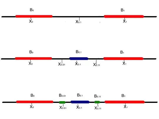

Here is an alternate proof that $\mathbb{R}$ is not the union of more than one disjoint closed interval. We continue with the convention that $(-\infty,a]$ and $[a,\infty)$ are regarded as closed intervals, but singletons are not.
Apology: I realise that many, many answers to this have been posted across the many linked posts and articles. I justify this post with the hope that the picture will make intuitive how to come up with this argument, without guidance from any theorems known in advance.
Assume that some collection of (more than one) disjoint closed intervals covers $\mathbb{R}$.
Let $x_0=0$. It lies in one of the intervals, which we denote $B_0$. Let $x_1\in \mathbb{R}$ be greater than any element of $B_0$. Then $x_1$ is also in one of the intervals which we denote $B_1$.
Now let $x_{0.1}$ denote the midpoint of the gap between $B_0$ and $B_1$. Let $B_{0.1}$ denote the interval that $x_{0.1}$ lies in. Note all decimals should be read in binary.
We continue to define $x_{0.01}$ as the midpoint of the gap between $B_0$ and $B_{0.1}$ and $x_{0.11}$ as the midpoint of the gap between $B_{0.1}$ and $B_{1}$. Again we denote by $B_{0.01}$ and $B_{0.11}$ the intervals which contain $x_{0.01}$ and $x_{0.11}$ respectively.
We continue this process inductively: Each new generation of intervals is obtained by taking the intervals from the cover, which contain the midpoints of the gaps between the previous intervals. In particular, given consecutive dyadic rationals $s,t$ from one generation, the midpoint of the gap between $B_s$ and $B_t$ is labelled $x_{(s+t)/2}$, and the interval containing it is labeled $B_{(s+t)/2}$.
Note that maximum length of a gap between intervals at least halves going from one generation to the next, as the new $x_s$ bisect the gaps between the old $B_t$. Thus there is no interval disjoint from the union of the $B_s$ over all dyadic rationals $s$. We conclude that our original cover is precisely the $B_s$, for dyadic rationals $s$.
It remains only to find a point not in any of the $B_s$. Simply take an irrational number $t\in [0,1]$:
$$t=0.t_1t_2t_3t_4t_5\cdots,$$ where each $t_i\in \{0,1\}$.
Let $x$ be the limit of the Cauchy sequence $$x_{0.t_1}, x_{0.t_1t_2},x_{0.t_1t_2t_3}, \cdots$$
For any interval $B_s$, this sequence will eventually be constrained to some gap between the intervals in the generation where $B_s$ appears. This gap may be to the left or right of $B_s$.
As $t$ is irrational, its binary decimal expansion does not end in an infinite sequence of $0$'s. Thus if the sequence eventually lies in a gap to the right of $B_s$, at some later point it will lie in a gap to the right of an interval $B_r$, which is to the right of $B_s$.
Similarly as $t$ is irrational, its binary decimal expansion does not end in an infinite sequence of $1$'s. Thus if the sequence eventually lies in a gap to the left of $B_s$, at some later point it will lie in a gap to the left of an interval $B_r$, which is to the left of $B_s$.
We conclude $x\notin B_s$.
