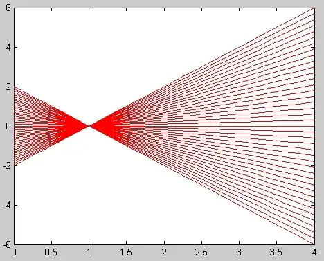

$$\frac{\partial u}{\partial t}+u\frac{\partial u}{\partial x}=0$$ There is a solution with each initial value, but this solution exists only for $t\le t_{r}$, where $t_{r}$ is a point where the phenomenon of "rollover" occurs. This phenomenon occurs if some characteristics of this equations intersect. Here is a picture of characteristics: enter image description here
It shows that characteristics of this equations intersect on the moment $t=1$
Before the moment $t=1$ the solution is:
$$u(x,t)=f(x-ut),$$ where $$f(x)=-x $$
After the point $t=1$ the solution does not exist. There you should change your equation to conservation law:

As discussed in the other answers and this post, the method of characteristics yields the classical solution $u = -(x-uy)$, i.e. $$ u(x,y) = \frac{-x}{1-y} \, . $$ Obviously, the denominator vanishes when $y$ reaches unity: the classical solution breaks down as $y\to 1$. This is reflected by the computation of the breaking time $$ y_b = \inf \frac{-1}{(-\text{id})'(x)} = 1 \, . $$ There, all the characteristic curves intersect simultaneously (cf. picture in answer by @cool), i.e. the solution $u$ takes simultaneously all the values from $−∞$ to $+∞$. It literally blows up! There is no weak solution (e.g. of shock-wave type) to start after this blow-up happened.

    I consider this solution be wrong (partially). The picture higher shows the real situation with characteristics -- they intersect at $y=1$, beginning from that point solution does not exist. – cool Jul 30 '13 at 13:09
