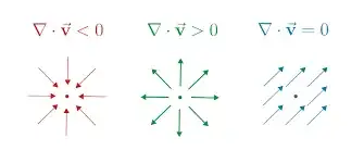

The Laplacian operator measures the deviation between a point and the average of its neighboring points.
A neighboring point where the value is lower will have its gradient pointing towards you. A neighboring point where the value is higher will have its gradient pointing away from you.
So the Laplacian is just the measure of average outgoingness of the gradient. But that's exactly what the divergence operator does.
For instance, if you think of the vector field above as the gradient of a function, the first one represents a local maximum (negative Laplacian), the second one represents a local minimum (positive Laplacian), the last one a region where the function is linear (in particular it is harmonic, zero Laplacian)
    yes this is very helpful. I get what you mean now. Thanks for the instructive diagrams as well. You answered exactly what I needed, so the gradient points towards higher values from a point--whether that is inward (towards me) or outward, and the divergence resolves whether the gradients near a point average inward or outward. Thanks again. – krishnab Oct 04 '22 at 15:15
