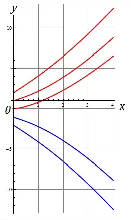

As a possible aid to others in possibly guessing analytical solution curve shapes, integrands of
$$\frac{dy}{dx}-c=\frac{x^2}{y}$$
with initial slope values $ y^{'}_{i}=c $ at $x=0 $ are numerically computed and plotted. When $c=0,$ $y\to k\cdot x^{3/2}$
( fwiw with no possible further consequence its second order ode .. if I made no error in differentiating is)
$$ \frac{y y'''-y''}{y'y''}= (2 c-1). $$
