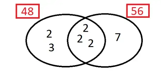

My favourite explanation of this involves Venn diagrams. Make a two-ellipse Venn diagram where ellipse $a$ contains the multiset of prime factors of $a$, and similarly for $b$. The Venn diagram intersection must be the multiset intersection. For instance, if $a=48=2^4\times 3$ and $b=56=2^3\times 7$ then their multiset of prime factors are $\{|2,2,2,3|\}$ and $\{|2,2,2,7|\}$ and this intersects at $\{|2,2,2|\}$, producing this Venn diagram:
We can see that the HCF is the product of the intersection ($2^3=8$), and the LCM is the product of each number in the diagram ($2^4\times 3\times 7=336$). If we multiply HCF and LCM then a number outside the intersection occurs once and a number inside the intersection occurs twice. Additionally, the product of the two numbers involves each number outside the intersection occurring once and each number inside the intersection occurring twice. So the two products coincide (here, $48\times 56=8\times 336=2688$).

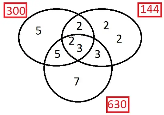

For example, with $a=300=2^2\times 3\times 5^2, b=144=2^4\times 3^2, c=630=2\times 3^2\times 5\times 7$, we have that $300\times 144\times 630=2721600$ and $\frac{(2^4\times 3^2\times 5^2\times 7)(12)(30)(18)}{6}=\frac{25200.12.30.18}{6}=2721600$.
Venn diagram for 300, 144, 630
I will conjecture from here that for $n$ numbers, we have a sort of alternating "inclusion-exclusion" pattern where we have the LCM of all numbers, then multiply by pairwise HCFs, then divide by three-way HCFs, then multiply by four-way HCFs and so forth.
