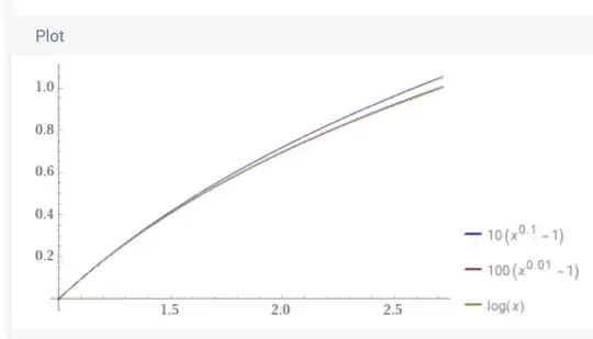

But how sure are you really that $\frac{x^{0.0001}}{0.0001}$ isn't "logarithm-y"? Here's a WolframAlpha plot of $\frac{x^h - 1}{h}$ for $h = 0.1, 0.01$ compared to a plot of $\ln x$, on the interval $[1, e]$:
I didn't include $h = 0.001$, let alone $h = 0.0001$, because the graphs are visually indistinguishable! To play around with this more, here's an interactive Desmos plot where you can adjust the value of $n$ in the graph of $\frac{x^{\frac{1}{n}} - 1}{\frac{1}{n}}$ and compare it to the graph of $\ln x$. To my eye you can barely tell the difference for $x \in [0, 10]$ by about $n \approx 50$.
