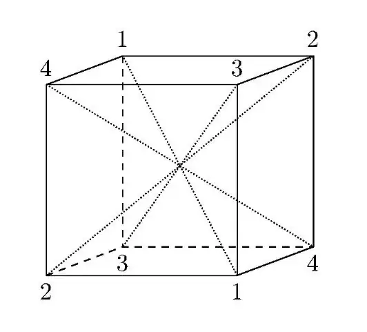

Here's a geometric construction.
The group of rotations of a cube is isomorphic to $S_4$. Indeed, you can view it as the action on the four diagonals of the cube.
(I took the picture from this answer)
Under this action, 180 degree rotations correspond to the non-trivial elements of the Klein 4 group.
Now consider the set of pairs of opposite faces of a cube. There are three such pairs. Labelling the pairs as $\{1 , 2, 3\}$ we get an action of $S_4$ on $\{1,2,3\}$, in other words, a homomorphism $S_4 \to S_3$.
The kernel of this homomorphism is exactly the rotations of the cube that fix each of the three pairs of opposite faces - i.e. it is exactly the Klein 4 group.
