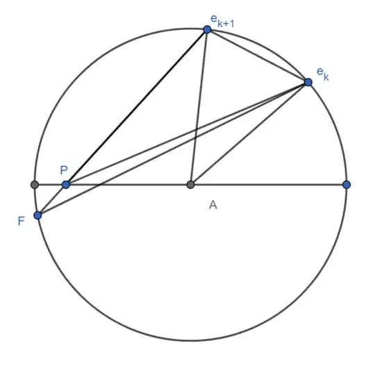

Enumerate the area of the regions, $a_1, \dots, a_n$, each region is bordered by two straight segments and a circular arc, enumerate the straight bordered regions $l_1, \dots, l_n$ so that the region with area $a_1$ is bordered by $l_1$ and $l_2$ (also $l_{n+1}=l_1$), enumerate the end points of $l_1, \dots, l_n$ as $e_1, \dots, e_n$. Define: $$L_n=\prod_{k=1}^na_k; L = \lim_{n \to \infty}L_n$$ We first prove the area of each section $a_k=\frac{\sin(\frac{2\pi}{n})}{2}l_kl_{k+1} + o(|x^{-1}|)$. Decompose the area of each $a_k$ as follows:
We want to prove that the area of triangle $e_{k}e_{k+1}P$ is $\frac{\sin(\frac{2\pi}{n})}{2}l_kl_{k+1}$ and area of the circular segment between $e_k$ and $e_{k+1}$ is $o(|n^{-1}|)$. The former is easy, just know that the area of a triangle is $\frac{ab}2\sin(\theta)$. The latter requires more work. Extend $Pe_{k+1}$ to intersect with the circle at $F$, it is apparent that the angle $2\pi/n=\angle e_kPe_{k+1}\geq \angle e_kFe_{k+1}$, and by inscribed angle theorem, we have $\angle 2e_kFe_{k+1}= \angle e_kAe_{k+1}$. Hence, $\angle e_kAe_{k+1} \leq 4\pi/n$. Now using the area for a cicular segment, we can derive: \begin{align} a_k & = \frac{\sin(\frac{2\pi}{n})}{2}l_kl_{k+1} + \frac{R^2}{2}(\angle e_kAe_{k+1}-\sin(\angle e_kAe_{k+1}))\\ & = \frac{\sin(\frac{2\pi}{n})}{2}l_kl_{k+1} + \frac{n}{2\pi(1-p^2)}(\angle e_kAe_{k+1}-\sin(\angle e_kAe_{k+1}))\\ & \leq \frac{\sin(\frac{2\pi}{n})}{2}l_kl_{k+1} + \frac{n(4\pi/n+\sin(4\pi/n))}{2\pi(1-p^2)}\\ \end{align} All that remains to be proven is $A := \lim_{n \to \infty}\frac{n^2(4\pi/n+\sin(4\pi/n))}{2\pi(1-p^2)} = 0$. Indeed, we may substitute $4\pi/n \to x$, remove constants, and evaluate instead at $0$ (because of the substitution) to get: \begin{align} A &= \lim_{n \to \infty}\frac{n^2(4\pi/n+\sin(4\pi/n))}{2\pi(1-p^2)}\\ &=\text{Constant}\lim_{x \to 0} \frac{x-\sin(x)}{x^2}\\ &=\text{Constant} \lim_{x \to 0}\frac{1-\cos(x)}{x}\\ &=\text{Constant} \lim_{x \to 0} \frac{\sin(x)}{1}=0 \end{align} Now we may finally move onto the actual problem.

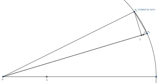

We wish to prove that $\prod_{k=1}^n l_{k,\theta} = \prod_{k=1}^n l_{k,\theta+\pi/n} + o(|n^{n/2}|)$. Indeed if we have this then we may break down the product of $l_k$s, via once again power of a point: \begin{align} L_{n,\theta} & = \left(\frac{\sin(\frac{2\pi}{n})}{2}\right)^n\left(\prod_{k=1}^n l_{k,\theta}\right)^2+ o(|1|)\\ & = \left(\frac{\sin(\frac{2\pi}{n})}{2}\right)^n\prod_{k=1}^n l_{k,\theta}\prod_{k=1}^n l_{k,\theta+\pi/n} + \prod_{k=1}^n l_{k,\theta}o(|n^{n/2}|)\left(\frac{\sin(\frac{2\pi}{n})}{2}\right)^n+ o(|1|)\\ & = \left(\frac{\sin(\frac{2\pi}{n})}{2}\right)^n\prod_{k=1}^n l_{k,\theta}\prod_{k=1}^n l_{k,\theta+\pi/n} + o(|1|)\\ & = \left(\frac{n\sin(2\pi/n)}{2\pi}\right)^n +o(|1|) \end{align} Returning us to the even case. enter image description here We can bound $De_k=l_{k,\theta}-l_{k,\theta+\pi/n}$ by the length of the cord between $e_k$ and $e_k'$. Which can be calculated by $$l_{k,\theta}-l_{k,\theta+\pi/n}\leq 2\sin(2\pi/n)$$ This means that: \begin{align} \prod_{k=1}^{n}l_{k,\theta+\pi/n} & \leq \prod_{k=1}^{n}(l_{k,\theta} + 2\sin(2\pi/n))\\ & = \prod_{k=1}^{n}(l_{k,\theta}) + \sum_{i=1}^n \prod_{j\neq i}(l_j)2\sin(2\pi/n))+\dots\\ & = \prod_{k=1}^{n}(l_{k,\theta}) + o(|n^{\frac{n}{2}}|) \end{align} Proven as required.
