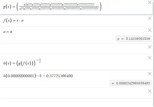

For $a=\pi$ the exact result is near from $3+\gamma$ see the picture below :
Approximation
What is this value $(a=\pi)$?

    The same techniques people including me mentioned on that other question also work here. You'll find a rational function $r$ exists for which the limit is $e^{r(\gamma)}$. – J.G. Sep 08 '22 at 10:03
    I get $e^{\gamma/(2-\gamma)}\approx1.500344$. – J.G. Sep 08 '22 at 10:13
  • @J.G. Hum okay can I add it in my question ? – Barackouda Sep 08 '22 at 10:21
    You can add that value if you like. I recommend you try adapting the other question's techniques to prove it. Remember, small $x$ satisfy $x!^{\circ n}\approx1-\gamma(1-\gamma)^{n-1}x$ for $n\ge1$. – J.G. Sep 08 '22 at 10:28
  • [For any recent reader, everything below "The exact value is $e^{\gamma/(2-\gamma)}$" is an edit postdating my previous comments.] My understanding is you want $\lim_{x\to}g(ax)^{-1/x}$ now you know the case $a=1$. Hint: substitute $y=ax$ to work it out. But your exposition is very unclear; for example, I think you meant to call this limit $h(a)$, not $h(x)$. – J.G. Sep 08 '22 at 13:42
