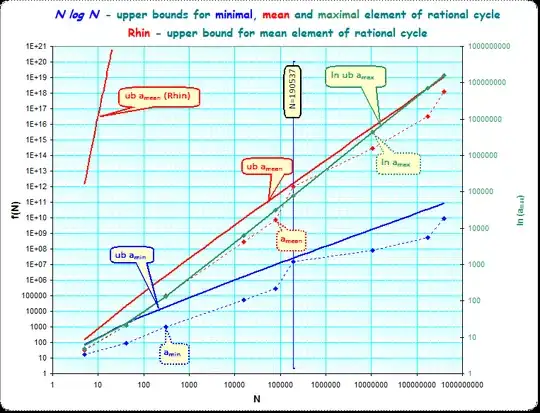

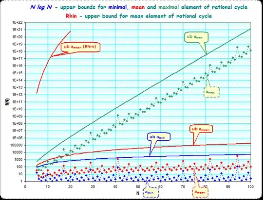

For $N$ (number of odd steps in my notation) and $S=\lceil N \cdot \log_2 3\rceil$ I conjecture that $$ {1 \over C \cdot N \cdot \ln N} \lt S \cdot \ln 2 - N \ln 3 \tag 1 $$ which holds, with $C=10$, for all $ 2< N <10^{1\,000\,000} $ with a remarkable smooth fitting curve (tested with Pari/GP with according digits precision). My derivations for $a_\min$, $a_\max$ and $\alpha=a_\text{mean}$ (denoting the according elements of a hypothetical cycle) are below; the result is that $$ \alpha \qquad (=a_\text{mean}) \lt C \cdot N^2 \ln N / 3 \qquad \text{with } C=11 \tag {2a}$$ $$ a_\min \lt (1-(2/3)^N) \cdot C \cdot N \ln N \qquad \text{with } C=11 \tag {2b}$$ $$ a_\max \lt 1.5^{N-1} \cdot ( C \cdot N \ln N +1)\qquad \text{with } C=11 \tag {2c}$$ In the tayloring of simple forms for the key-values $a_\min,a_\max,\alpha$ I leave small errors out; that errors are captured by the increase of $C=10$ to $C=11$ in the formulae. I think, that process of calculation can be made more precise with more work invested...
Pictures:
In the following a plot of the empirical (rational) values for the key values as colored dots, the bounds giving continuous curves of related colors, and the Rhin-bound for the $\alpha$-value for $N=1 \ldots 100$ is inserted to compare the preciseness of the estimates: picture1
To see wider range, but not be killed by oversizing there is another plot where I use the most critical cases $N$, but only that $N$ from the continued fractions of $\log_2 3$, so $N \in \{1,5,41,306,15601,79335,190537 , \ldots \} $ Here $N=190537$ is the most critical point for the upper bounds; to satisfy the bounds at this coordinate I needed to adapt $C=11$ to compensate the neglected error-terms in the definition of the key-values.
Note: the $a_\max$ values increase too much for a good display in the picture, so for the $a_\max$-values I document their logarithms, see the related y-scale on the rhs of the picture.

  • Hmm, in the route of eqns $(a4)$ to $(4e)$ I'm using arguments of $a_\min \lt ;$ something. Usually I'm thinking the other way around: $a_\min \gt ;$ something (and from that $a_\max \lt$ something and all $a_k$ are somewhere in that interval). So I'm getting doubts, whether that arguing is actually meaningful at all; it surely seems meaningful in regard to $a_\max$. Maybe simply a local confusion... – Gottfried Helms Sep 09 '22 at 00:14
    Your conjecture is consistent with the fact that almost all numbers have an irrationality measure equal to 2. One may expect that Rhin inequality still holds (asymptotically) when the exponent 13.3 is replaced by 1+$\varepsilon$ with $\varepsilon > 0$, for which no one has a proof up to now. – Olivier Rozier Sep 09 '22 at 14:17
  • @OlivierRozier - good comment, thanks! Yes, before my current conjecture I tried to adapt small exponents, like $\varepsilon =0.06$ and so, but looking at really large $N$ the hullcurve looked always a bit "insane", so to say... I had the $\ln N$ component in an earlier, much rougher, estimate - but "replacing" the $\varepsilon$ by the $\ln N$-component looked immediately very nice even along very wide intervals... – Gottfried Helms Sep 09 '22 at 14:26
