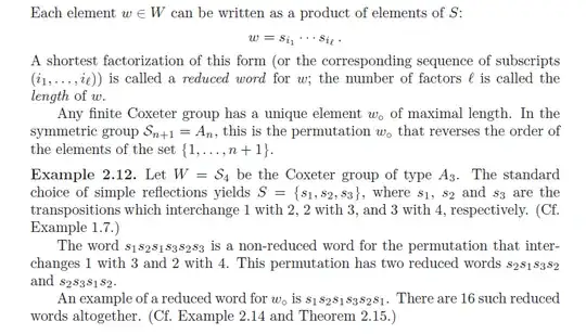

I have a finite reflection (or Coxeter) group defined abstractly through the standard presentation
$$(s_i s_j)^{c_{ij}}=1$$
For each of its elements I want to find the number of reduced words equal to it. Is this possible in GAP or one of its packages?
Here's an excerpt from a paper that gives more details : enter image description here

  • I don't think this will work. Maybe there's more than one definition for "reduced word". I edited the question to give the definition from the paper I'm reading. If I use MappedWord then $s_1 s_1$ would count a reduced word of length 2 for identity; but the paper's definition wouldn't count it that way. – unknown Sep 04 '22 at 02:13

  • @DerekHolt the paper uses type $A_3$ as an example (symmetric group on 4 elements); so that would be good to use since I can check the results. The Coxeter length is 6; so that's the maximum length. For example the paper gets 16 reduced words for the Coxeter element....Appreciate your offer to solve this example. – unknown Sep 04 '22 at 08:55
