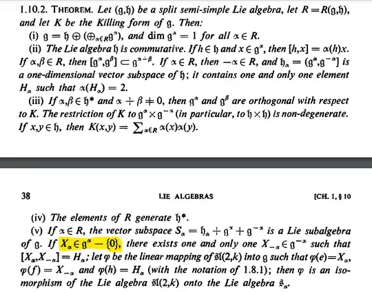

UPDATE: The first mention of $X_\alpha$ I have found in Dixmier is in this theorem, so I assume the definition is solved. However, I am still grateful for any insights about the ideal generated by such elements and the rest of my question. enter image description here
I don't have my copy of Dixmier's textbook at hand, and therefore I can't tell exactly where the $X_\alpha$'s are defined (but I have no doubt that the definition is done in the first chapter). Anyway, what matters here is that $X_\alpha\in\mathfrak g_\alpha\setminus\{0\}$. Since $\dim\mathfrak g_\alpha=1$, the exact choice of $X_\alpha$ doesn't matter as far as the definition of $I_\lambda$ is concerned.
By the way, $I_\lambda$ is the ideal of $\mathcal U(\mathfrak g)$ generated by the $X_\alpha$'s and also by the elements of the form $H-\lambda(H)1$, with $H\in\mathfrak h$.
