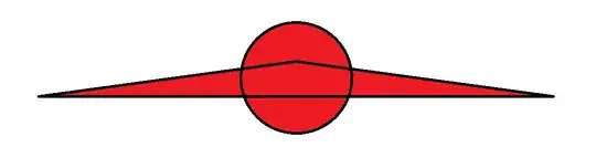

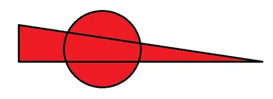

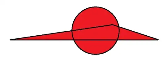

I received this question long time ago from one of my old friends who is mathematician/physicist. He called it the hardest geometry question with "a triangle" and "a circle". I am not sure if he know the answer or not. Here it is.
Note: These picture are just the example of possible answer. The actual answer might look like one of these or not like any of these.
The circle intersects the triangle and divides the area into 5 parts. Each 5 parts of the red-fill areas have equal area. The radius of circle is 1.
That is all the information the question gives. Then the question asks these two things.
  • Find the distance from the center of the circle to the centroid of the triangle. If there are more than 1 possible solutions, find longest and shortest possible the distance from the center of the circle to the centroid of the triangle.
  • Find length of outer perimeter of the new intersecting shape. If there are more than 1 possible solutions, find longest and shortest possible length of outer perimeter of new intersecting shape.
Note : If you think that there is only 1 possible solutions that the triangle is isosceles, you also have to proof that there is really only 1 possible solutions.
I have to say that I don't even know how to start to solve this question. The question doesn't even specify the type of the triangle. I think the triangle has to be isosceles triangle, but I remember that the question doesn't specify it.
Edit: I realize where I get this question from. And for now, I doubt if the triangle has to be isosceles or not.
Edit(2) : Due to some technical reason, the account of the real original poster is merged to my account. That is why there is a delay of the update on this question. I do contact and take to the real original poster. Here is why he edit this question.
After sometimes, I decide to change the original question a bit by adding more picture. The original question is actually tricky that give only the first image and trick anyone who try to solve it that that is how the answer look like. R. J. Mathar and John Bentin answer is good but that isn't what the original question ask for.
Edit(3) : The question might not have analytical solution. So, if there is no analytical solution, numerical solution is acceptable.

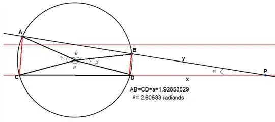

We prove here the non-unicity of the required triangles. It is clear that if two circular segments on a circle have same area, also have same length of chord. In the unitary circle we are concerned with two disjoint circular segments having area $\dfrac{\pi}{3}$ because the circle has area equal to $\pi$. The involved chord have length, noted $a$, given by the system
$$\dfrac{\theta-\sin(\theta)}{2}=\dfrac{\pi}{3}\\a=2\sin\left(\frac{\theta}{2}\right)$$ from which we have the data for the problem to solve (see at attached figure) $$\begin{cases}\theta\approx 2.60533\\ a\approx 1.92853529\end{cases}$$
To determine the outer region having area equal to $\dfrac{\pi}{3}$ we have five unknowns, , $\alpha,\beta, \gamma,x$ and $y$ for which we have the following system of five equations. $$\begin{cases}2\theta+\beta+\gamma=2\pi\\\\\alpha=\dfrac{\gamma-\beta}{2}\\\\(a+y)y=(a+x)x\\\\\dfrac{xy\sin(\alpha)-(\beta-\sin(\beta))}{2}=\dfrac{\pi}{3}\\\\(2\sin(\beta))^2=x^2+y^2-2xy\cos(\alpha)\end{cases}$$ From which $\gamma=\pi-\theta+\alpha=0.536262653+\alpha$ and $\beta=\pi-\theta-\alpha=0.536262653-\alpha$.
Put for confort $A=0.536262653$ and $B=\dfrac{2\pi}{3}=2.0943951$ so we have the system of three unknowns. $$\begin{cases}(a+y)y=(a+x)x\\\\{xy\sin(\alpha)-A+\alpha+\sin(A-\alpha)}=B\\\\\left(2\sin(A-\alpha)\right)^2=x^2+y^2-2xy\cos(\alpha)\end{cases}$$ Note that $y=x$ because the chords $\overline{AB}=\overline{CD}$ (or because $(a+y)y=(a+x)x\iff(y-x)(y+x-a)=0)$ so we have the resultant in $\alpha$
$$x^2=\dfrac{B+A-\alpha-\sin(A-\alpha)}{\sin(\alpha)}=\dfrac{2\sin^2(A-\alpha)}{1-\cos(\alpha)}$$ i.e. $$\dfrac{2.6306577-\alpha-\sin(0.5362626-\alpha)}{\sin(\alpha)}=\dfrac{2\sin^2(0.5362626-\alpha)}{1-\cos(\alpha)}$$ from where we get $\alpha\approx 0.203$ radiands.
This value of $\alpha$ determines the position of point $P$ in the figure because the chord $\overline{AB}$ should have constant length $a\approx 1.92853529$ (optionnally one can calculate $x$ having $\alpha$). This position of vertex $P$ is unique because if the point $A$ change of position then the outer region $PBD$ becomes larger or smaller than $\dfrac{\pi}{3}$.
Regarding the other outer part of the triangle, that one with two vertices, the mean value theorem ensures the existence of a lot of possible shapes according with the angle we consider between two sides of the triangle. The effective calculation I suppose can be made in analogous way to that for region $BDP$.

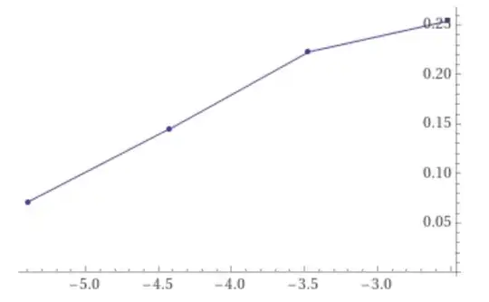

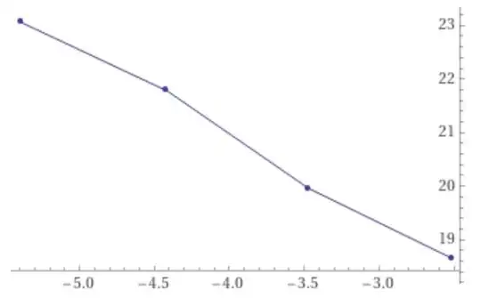

Starting from @John Bentin's answer, the zero of function $$f(\alpha)=\sin(2\alpha)-2\alpha+\frac23\pi$$ can be obtained using a series expansion around $\alpha=\frac \pi 2$.
$$f(\alpha)=-\frac{\pi }{3}-4 \left(\alpha -\frac{\pi }{2}\right)+\frac{4}{3} \left(\alpha -\frac{\pi }{2}\right)^3-\frac{4}{15} \left(\alpha -\frac{\pi }{2}\right)^5+O\left(\left(\alpha -\frac{\pi }{2}\right)^7\right)$$ Using series reversion, then
$$\alpha=\frac{\pi }{2}-\frac{1}{4} \left(f(\alpha)+\frac{\pi }{3}\right)-\frac{1}{192} \left(f(\alpha)+\frac{\pi }{3}\right)^3-\frac{1}{3840}\left(f(\alpha)+\frac{\pi }{3}\right)^5+O\left(\left(f(\alpha)+\frac{\pi}{3}\right)^7\right)$$ So, since we need $f(\alpha)=0$, the approximation $$\alpha \sim\frac{5 \pi }{12}-\frac{\pi ^3}{5184}-\frac{\pi ^5}{933120}=1.30269$$ while Newton method gives $\alpha=1.30266$.
Using the first series, it gives $$\cos(\alpha)=\frac{1}{4} \left(f(\alpha)+\frac{\pi }{3}\right)+\frac{1}{384} \left(f(\alpha)+\frac{\pi }{3}\right)^3+\frac{13 }{122880}\left(f(\alpha)+\frac{\pi }{3}\right)^5+O\left(\left(f(\alpha)+\frac{\pi }{3}\right)^7\right)$$ that is to say $$\cos(\alpha)\sim \frac{\pi }{12}+\frac{\pi ^3}{10368}+\frac{13 \pi ^5}{29859840} =0.264923$$ instead of $\cos(\alpha)=0.264932$.
Repeating the same process for the second equation around $\theta=\frac \pi 2$, using $c=\cos(\alpha)$ $$\theta=\frac \pi 2-\frac{3 \left(\frac{\pi ^3}{36}-\left(c+\frac{\pi }{6}\right)^2\right)}{6 c-2 \pi ^2+\pi }-\frac{9 \left(\frac{\pi ^3}{36}-\left(c+\frac{\pi }{6}\right)^2\right)^2 (c (6 c+\pi )+24 \pi -6)}{2 \left(6 c-2 \pi ^2+\pi \right)^3}+\cdots$$ Replacing $c$ by its approximation gives $$\theta \sim 1.62583$$
Edit
Using my favored $1,400^+$ years old approximation of the sine function $$\sin(x) \simeq \frac{16 (\pi -x) x}{5 \pi ^2-4 (\pi -x) x}\qquad (0\leq x\leq\pi)$$ let $x=2\alpha$ and we need to solve the cubic $$4 x^3+\left(16-\frac{20 \pi }{3}\right) x^2+\frac{1}{3} \pi (23 \pi -48) x-\frac{10 \pi ^3}{3}=0$$ which has only one real root $$x=\left(\frac{5 \pi }{9}-\frac{4}{3}\right)-\frac{\sqrt{\pi (48+107 \pi )-576}}{9} \times $$ $$ \sinh \left(\frac{1}{3} \sinh ^{-1}\left(\frac{13824-\pi (1728+\pi (6732+325 \pi ))}{(\pi (48+107 \pi )-576)^{3/2}}\right)\right)$$ which gives $\alpha=1.30264$.

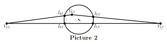

I am not a mathematician but when I read R. J. Mathar's answer and some comment, I somehow found way to solve the problem.

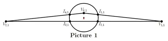

I use the set up very similar to R. J. Mathar's answer and extend it to other possible solutions. Then I found that the all possible solutions are one of these case.
It take me many days to find answer and draw the picture since I am not expert in drawing in tikz. Here is my attempt.
Let
  • The small black dot is Center of the circle which is at origin point $O$ (at $(0,0)$)
  • Each vertex of triangle $V_0,V_1,V_2$ is at position $(x_0,y_0)$,$(x_1,y_1)$,$(x_2,y_2)$ and have angle $\theta_0,\theta_1,\theta_2$ (in radian) in order.
  • Each intersect point $I_1,I_2,I_3,I_4$ is at position $(I_{1,x},I_{1,y}),(I_{2,x},I_{2,y}),(I_{3,x},I_{3,y}),(I_{4,x},I_{4,y})$ in order when $I_1$ is the intersect point at right-above and then rotate clockwise.
  • $P$ is the outer perimeter of the new intersecting shape
  • The red dot is Centroid of triangle $C$ which is at position $(C_x,C_y)=(\frac{x_0+x_1+x_2}{3},\frac{y_0+y_1+y_2}{3})$
Note : Only Picture 2 is in precisely approximate picture but still not actual picture. All other pictures are actual picture that use (x,y) position from the result.
Picture 1 Picture 2 Picture 3 Picture 4 Picture 5
$\hspace{150pt}$ Picture 1 : $x_0=0$
Picture 1 case is R. J. Mathar's answer.
From R. J. Mathar's set up, all $y_1$ and $y_2$ in every cases are always approximately equal to -0.264932. And all $I_2$ and $I_3$ in every cases are at same position.
\begin{align} x_{0,1} &= 0 \\ y_{0,1} &\approx 0.317324 \\ x_{1,1} &\approx 5.39554 \\ y_{1,1} &\approx -0.264932 \\ x_{2,1} &\approx -5.39554 \\ y_{2,1} &\approx -0.264932 \\ C_{x,1} &= 0 \\ C_{y,1} &\approx \frac{0.317324+(-0.264932)+(-0.264932)}{3} \approx -0.0708467 \\ |\overline{OC_1}|=C_{y,1} &\approx 0.0708467 \end{align}
From R. J. Mathar's answer, $t_0\approx0.181130$.
Finding all intersect point of Picture 1 ($I_{1,1},I_{2,1},I_{3,1},I_{4,1}$)
\begin{align} I_{1,x,1}=x_{0,1}+t_0(x_{1,1}-x_{0,1}) &\approx 0+0.181130(5.39554-0) \approx 0.977294 \\ I_{1,y,1}=y_{0,1}+t_0(y_{1,1}-y_{0,1}) &\approx 0.317324+0.181130((-0.264932)-0.317324) \approx 0.211860 \\ I_{2,x,1}=\sqrt{1-y_{1,1}^2} &\approx \sqrt{1-(-0.264932)^2} \approx 0.964267 \\ I_{2,y,1}=y_{1,1} &\approx -0.264932 \\ I_{3,x,1}=-I_{2,x,1} &\approx -0.964267 \\ I_{3,y,1}=I_{2,y,1} &\approx -0.264932 \\ I_{4,x,1}=-I_{1,x,1} &\approx -0.977294 \\ I_{4,y,1}=I_{1,y,1} &\approx 0.211860 \end{align}
Finding outer perimeter of Picture 1 ($P_1$)
\begin{align} P_1 =&\ |\overline{V_{1,1} I_{1,1}}| + |\overline{V_{1,1} I_{2,1}}| + (Circle\ Curve\ I_{2,1}\ to\ I_{3,1}) + |\overline{V_{2,1} I_{3,1}}| + |\overline{V_{2,1} I_{4,1}}| + (Circle\ Curve\ I_{3,1}\ to\ I_{4,1}) \\ =&\ 2(\sqrt{(x_{1,1}-I_{1,x,1})^2+(y_{1,1}-I_{1,y,1})^2} + \sqrt{(x_{1,1}-I_{2,x,1})^2+(y_{1,1}-I_{2,y,1})^2}) + 2\arcsin(I_{2,x,1}) + 2\arcsin(I_{1,x,1}) \\ \approx&\ 2(\sqrt{(5.39554-0.977294)^2+((-0.264932)-0.211860)^2} + \sqrt{(5.39554-0.964267)^2+0}) + 2\arcsin(0.964267) + 2\arcsin(0.977294) \\ \approx&\ 23.0702 \end{align}

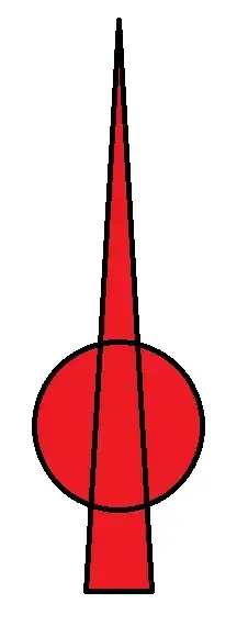

$\hspace{150pt}$ Picture 2 : $|x_0|>0$ and $|\overline{V_0 O}|<1$
In Picture 2 and after picture, when we shift $V_0$ from the center line, the picture will lose the symmetry. Shifting to the left or right will give the similar answer but in mirror image of each other, so I will calculate only shifting to the left case.
The is the hardest one that I can't solve. I will talk about Picture 2 later in Discussion.

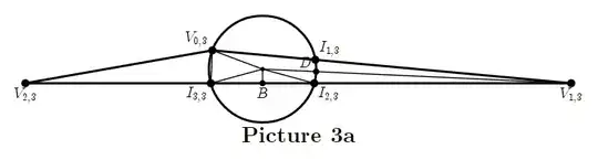

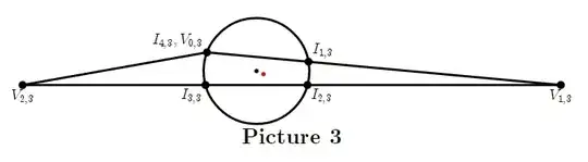

$\hspace{150pt}$ Picture 3 : $|\overline{V_0 O}|=1$
If we keep shifting the top vertex, at specific point we will get Picture 3 where $V_0$ and $I_4$ is the same point.
To find each value, I draw these additional lines
Picture 3 solve
Because from the initial condition that each area are equal, we get
\begin{align} |\overline{V_{0,3} V_{1,3}}| &= |\overline{I_{3,3} V_{1,3}}| \\ |\overline{V_{0,3} I_{1,3}}| &= |\overline{I_{3,3} I_{2,3}}| \\ |\overline{I_{1,3} V_{1,3}}| &= |\overline{I_{2,3} V_{1,3}}| \end{align}
The triangle $V_{0,3}I_{3,3}V_{1,3}$ is isoscale triangle and line $\overline{OV_{1,3}}$ divide $\theta_{1,3}$ in to two equal angles. From this, we get
\begin{align} y_{1,3} &= y_{1,1} \approx -0.264932\\ |I_{2,x,3}| &= \sqrt{1-(y_{1,3})^2} \approx \sqrt{1-(-0.264932)^2} \approx 0.964267 \\ \frac{(Area\ V_{0,3}I_{3,3}V_{1,3})}{2} &= (Area\ OBV_{1,3}) - (Area\ OBI_{2,3}) - (Area\ ODI_{2,3}) \\ \frac{(\frac{\pi}{3})}{2} &= \frac{1}{2}|x_{1,3}||y_{1,3}| - \frac{1}{2}|I_{2,x,3}||y_{1,3}| - \pi\frac{\arctan(\frac{|x_{1,3}|}{|y_{1,3}|})-\arctan(\frac{|I_{2,x,3}|}{|y_{1,3}|})}{2\pi} \\ \frac{\pi}{6} &= \frac{0.264932}{2}|x_{1,3}| - \frac{0.264932}{2}(0.964267) - \frac{\arctan(\frac{|x_{1,3}|}{0.264932})-\arctan(\frac{0.964267}{0.264932})}{2} \\ \end{align}
This equation can be solved for $|x_{1,3}|$ analytically since there are both $|x_{1,3}|$ and $\arctan(\frac{|x_{1,3}|}{0.264932})$, so I use Wolframalpha to solve it. From picture $x_{1,3}>0$, we get
\begin{align} (Wolframalpha) \rightarrow x_{1,3} &\approx 5.75543 \\ y_{1,3} &\approx -0.264932 \\ \theta_{1,3} = 2\arctan(\frac{|x_{1,3}|}{|y_{1,3}|}) &\approx 0.0919984 \\ I_{2,x,3} = I_{2,x,1} = &\approx 0.964267 \\ I_{2,y,3} = I_{2,x,1} = &\approx -0.264932 \\ I_{3,x,3} = -I_{2,x,3} &\approx -0.964267 I_{3,y,3} = I_{2,x,1} = &\approx -0.264932 \\ I_{1,x,3} = x_{1,3} - (|x_{1,3}|-|I_{2,x,3}|)\cos(\theta_{1,3}) &\approx 0.984528 \\ I_{1,y,3} = y_{1,3} + (|x_{1,3}|-|I_{2,x,3}|)\sin(\theta_{1,3}) &\approx 0.175226 \\ x_{0,3} = x_{1,3} - (|x_{1,3}|+|I_{2,x,3}|)\cos(\theta_{1,3}) &\approx -0.935850 \\ y_{0,3} = y_{1,3} + (|x_{1,3}|+|I_{2,x,3}|)\sin(\theta_{1,3}) &\approx 0.352398 \\ \end{align}
Finding $x_{2,3}$
\begin{align} (Angle\ \widehat{I_{3,3}OV_{0,3}}) &= 2\pi - 4\arctan(\frac{|I_{2,x,3}|}{|y_{1,3}|}) - 2\left(\arctan(\frac{|x_{1,3}|}{|y_{1,3}|})-\arctan(\frac{|I_{2,x,3}|}{|y_{1,3}|})\right) \\ &\approx 0.628265 \\ (Chord\ Area\ I_{3,3}V_{0,3}) &= \frac{(Angle\ \widehat{I_{3,3}OV_{0,3}})-sin(Angle\ \widehat{I_{3,3}OV_{0,3}})}{2}\\ &\approx 0.0202615 \\ (Area\ I_{3,3}V_{2,3}V_{0,3}) &= (Area\ Triangle\ I_{3,3}V_{2,3}V_{0,3}) - (Chord\ Area\ I_{3,3}V_{0,3}) \\ \frac{\pi}{3} &= \frac{1}{2}(|x_{2,3}|-|I_{3,x,3}|)(|y_{0,3}|+|y_{1,3}|) - (Chord\ Area\ I_{3,3}V_{0,3}) \\ \frac{\pi}{3} &\approx \frac{1}{2}(|x_{2,3}|-0.964267)(0.352398+0.264932) - 0.0202615 \\ |x_{2,3}| &\approx 4.42258 \\ (x_{2,3}<0) \rightarrow x_{2,3} &\approx -4.42258 \\ y_{2,3} &\approx -0.264932 \\ \end{align}
Finding centroid ($C_3$)
\begin{align} C_{x,3} = \frac{x_{0,3}+x_{1,3}+x_{2,3}}{3} &\approx 0.132333 \\ C_{y,3} = \frac{y_{0,3}+y_{1,3}+y_{2,3}}{3} &\approx -0.059155 \\ |\overline{OC_3}|=\sqrt{C_{x,3}^2+C_{y,3}^2} &\approx 0.144950 \end{align}
Finding outer perimeter ($P_3$)
\begin{align} P_3 =&\ |\overline{V_{2,3} V_{0,3}}| + |\overline{V_{2,3} I_{3,3}}| + 2|\overline{I_{2,3} V_{1,3}}| + 2(Circle\ Curve\ I_{2,3}\ to\ I_{3,3})\\ =&\ \sqrt{(x_{2,3}-x_{0,3})^2+(y_{2,3}-y_{0,3})^2} + |x_{2,3}-I_{3,x,3}| + 2|I_{2,x,3}-x_{1,3}| + 2(2\arcsin(I_{2,x,3}))\\ \approx&\ 21.7922 \end{align}

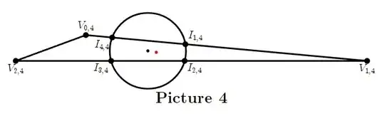

$\hspace{150pt}$ Picture 4 : $|\overline{V_0 O}|>1$ and $|\overline{V_0 V_1}|<|\overline{V_2 V_1}|$
In Picture 4, $V_{1,4},I_{1,4},I_{2,4},I_{3,4},I_{4,4},$ are the same point as in Picture 3, so
\begin{align} x_{1,4} &\approx 5.75543 \\ y_{1,4} &\approx -0.264932 \\ I_{1,x,4} &\approx 0.984528 \\ I_{1,y,4} &\approx 0.175226 \\ I_{2,x,4} &\approx 0.964267 \\ I_{2,y,4} &\approx -0.264932 \\ I_{3,x,4} &\approx -0.964267 \\ I_{3,y,4} &\approx -0.264932 \\ I_{4,x,4}=x_{0,3} &\approx -0.935850 \\ I_{4,y,4}=y_{0,3} &\approx 0.352398 \\ \theta_{1,4}=\theta_{1,3} &\approx 0.0919984 \\ y_{2,4}= y_{1,4} &\approx -0.264932 \end{align}
There are infinite solutions for Picture 4 where $x_{2,3}<x_{2,4}<x_{2,5}$. In Picture 4, I use $x_{2,4}=\frac{x_{2,3}+x_{2,5}}{2}$
Finding relation between $x_{2,4}$ and $x_{0,4},y_{0,4}$
\begin{align} |\overline{V_{0,4}V_{1,4}}| &= |\overline{V_{0,4}I_{4,4}}| + |\overline{I_{4,4}V_{1,4}}|\\ &= |\overline{V_{0,4}I_{4,4}}| + |\overline{I_{3,4}V_{1,4}}|\\ &= \left(\frac{|x_{0,4}|-|I_{4,x,4}|}{cos(\theta_{1,4})}\right) + (|I_{3,x,4}|+|x_{1,4}|)\\ (Area\ Triangle\ V_{0,4}V_{1,4}V_{2,4}) &= \frac{1}{2}|\overline{V_{2,4}V_{1,4}}||\overline{V_{0,4}V_{1,4}}|sin(\theta_{1,4}) \\ \pi &= \frac{sin(\theta_{1,4})}{2}(|x_{2,4}|+|x_{1,4}|)\left(\left(\frac{|x_{0,4}|-|I_{4,x,4}|}{cos(\theta_{1,4})}\right) + (|I_{3,x,4}|+|x_{1,4}|)\right) \\ \frac{2\pi}{sin(0.0919984)} &\approx (|x_{2,4}|+|5.75543|)\left(\left(\frac{|x_{0,4}|-|-0.935850|}{cos(0.0919984)}\right) + (|-0.964267|+|5.75543|)\right) \\ |x_{0,4}| &\approx \frac{34.9789 - 5.75543|x_{2,4}|}{|x_{2,4}|+5.75543} \\ (Area\ Triangle\ V_{0,4}V_{1,4}V_{2,4}) &= \frac{1}{2}(Base\ Length)(Height\ Length) \\ \pi &= \frac{1}{2}|\overline{V_{2,4}V_{1,4}}|(|y_{0,4}|+|y_{1,4}|) \\ 2\pi &= (|x_{2,4}|+|x_{1,4}|)(|y_{0,4}|+|y_{1,4}|) \\ 2\pi &\approx (|x_{2,4}|+|5.75543|)(|y_{0,4}|+|-0.264932|) \\ |y_{0,4}| &\approx \frac{2\pi}{|x_{2,4}|+5.75543}-0.264932 \\ \end{align}
From Picture 4, $x_{0,4},x_{2,4}<0$ and $y_{0,4}>0$
\begin{align} x_{0,4} &\approx -\frac{5.75543x_{2,4} + 34.9789}{5.75543-x_{2,4}} \\ y_{0,4} &\approx \frac{2\pi}{5.75543-x_{2,4}}-0.264932 \\ \end{align}
Finding centroid ($C_4$) when $x_{2,3}<x_{2,4}<x_{2,5}$
\begin{align} C_{x,4} &= \frac{x_{0,4}+x_{1,4}+x_{2,4}}{3} \\ &\approx \frac{-\frac{5.75543x_{2,4} + 34.9789}{5.75543-x_{2,4}}+5.75543+x_{2,4}}{3} \\ &\approx \frac{x_{2,4}^2+5.75543x_{2,4}+1.85401}{3(x_{2,4}-5.75543)} \\ C_{y,4} &= \frac{y_{0,4}+y_{1,4}+y_{2,4}}{3} \\ &\approx \frac{\left(\frac{2\pi}{5.75543-x_{2,4}}-0.264932\right)+(-0.264932)+(-0.264932)}{3} \\ &\approx \frac{0.264932x_{2,4}+0.569598}{5.75543-x_{2,4}} \\ |\overline{OC_4}| &= \sqrt{C_{x,4}^2+C_{y,4}^2} \\ &\approx \sqrt{\left(\frac{x_{2,4}^2+5.75543x_{2,4}+1.85401}{3(x_{2,4}-5.75543)}\right)^2+\left(\frac{0.264932x_{2,4}+0.569598}{5.75543-x_{2,4}}\right)^2} \\ &\approx \frac{\sqrt{x_{2,4}^4+11.5109x_{2,4}^3+37.4645x_{2,4}^2+24.0565x_{2,4}+6.35702}}{3(5.75543-x_{2,4})} \end{align}
Finding outer perimeter ($P_4$)
\begin{align} 2|\overline{I_{2,4} V_{1,4}}| + 2(Circle\ Curve\ I_{2,4}\ to\ I_{3,4}) =&\ 2|I_{2,x,4}-x_{1,4}| + 2(2\arcsin(I_{2,x,4}))\\ \approx&\ 14.7930 \end{align} \begin{align} P_4 =&\ |\overline{V_{2,4} V_{0,4}}| + |\overline{I_{4,4} V_{0,4}}| + |\overline{V_{2,4} I_{3,4}}| + 2|\overline{I_{2,4} V_{1,4}}| + 2(Circle\ Curve\ I_{2,4}\ to\ I_{3,4})\\ =&\ \sqrt{(x_{2,4}-x_{0,4})^2+(y_{2,4}-y_{0,4})^2} + \sqrt{(I_{4,x,4}-x_{0,4})^2+(I_{4,y,4}-y_{0,4})^2} + |x_{2,4}-I_{3,x,4}| + 14.7930 \\ =&\ \sqrt{\left(x_{2,4}-\left(-\frac{5.75543x_{2,4} + 34.9789}{5.75543-x_{2,4}}\right)\right)^2+\left((-0.264932)-\left(\frac{2\pi}{5.75543-x_{2,4}}-0.264932\right)\right)^2} + \sqrt{\left((-0.935850)-\left(-\frac{5.75543x_{2,4} + 34.9789}{5.75543-x_{2,4}}\right)\right)^2+\left(0.352398-\left(\frac{2\pi}{5.75543-x_{2,4}}-0.264932\right)\right)^2} + ((-0.964267)-x_{2,4}) + 14.7930 \\ \approx&\ \frac{\sqrt{x_{2,4}^4 - 23.0217 x_{2,4}^3 + 62.5421 x_{2,4}^2 + 805.274 x_{2,4} + 1263.00}+\sqrt{45.1543 x_{2,4}^2 + 399.397 x_{2,4} + 883.181}}{5.75543-x_{2,4}}+13.8287-x_{2,4} \end{align}
I will explain about these centroid ($C_4$) function and outer perimeter ($P_4$) function more in Discussion.

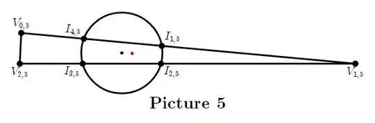

$\hspace{150pt}$ Picture 5 : $|\overline{V_0 V_1}|=|\overline{V_2 V_1}|$
Picture 5 is the special case of Picture 4 when |\overline{V_0,5 V_1,5}|=|\overline{V_2,5 V_1,5}|.
If we move $x_{2,5}$ to the right more, we will get the mirror image of Picture 4.
From Picture 4, we get
\begin{align} x_{1,5} &\approx 5.75543 \\ y_{1,5} &\approx -0.264932 \\ I_{1,x,5} &\approx 0.984528 \\ I_{1,y,5} &\approx 0.175226 \\ I_{2,x,5} &\approx 0.964267 \\ I_{2,y,5} &\approx -0.264932 \\ I_{3,x,5} &\approx -0.964267 \\ I_{3,y,5} &\approx -0.264932 \\ I_{4,x,5} &\approx -0.935850 \\ I_{4,y,5} &\approx 0.352398 \\ \theta_{1,5} &\approx 0.0919984 \\ y_{2,5}= y_{1,5} &\approx -0.264932 \end{align}
Finding $x_{2,5}$ when $x_{2,5}<0$
\begin{align} (Area\ Triangle\ V_{0,5}V_{1,5}V_{2,5}) &= \frac{1}{2}|\overline{V_{2,5}V_{1,5}}||\overline{V_{0,5}V_{1,5}}|sin(\theta_{1,5}) \\ 2\pi &= (|x_{2,5}|+|x_{1,5}|)^2sin(\theta_{1,5}) \\ \frac{2\pi}{sin(0.0919984)} &\approx (|x_{2,5}|+5.75543)^2 \\ x_{2,5} &\approx -2.51458 \end{align}
We can use the formula of $x_{0,4},y_{0,4},C_{x,4},C_{y,4},|\overline{OC_4}|,P_4$ from Picture 4 to calculate those value for Picture 5. But I will calculate those value with geometry instead and use the value I get to check if those formula are correct or not.
\begin{align} x_{0,5} = x_{1,5} - (|x_{1,5}|+|x_{2,5}|)\cos(\theta_{1,5}) &\approx -2.47961 \\ y_{0,5} = y_{1,5} + (|x_{1,5}|+|x_{2,5}|)\sin(\theta_{1,5}) &\approx 0.494823 \\ C_{x,5}= \frac{x_{0,5}+x_{1,5}+x_{2,5}}{3} &\approx 0.253748 \\ C_{y,5}= \frac{y_{0,5}+y_{1,5}+y_{2,5}}{3} &\approx -0.011680 \\ |\overline{OC_5}|=\sqrt{C_{x,5}^2+C_{y,5}^2} &\approx 0.254017 \end{align} \begin{align} 2|\overline{I_{2,5} V_{1,5}}| + 2(Circle\ Curve\ I_{2,5}\ to\ I_{3,5}) =&\ 2|I_{2,x,5}-x_{1,5}| + 2(2\arcsin(I_{2,x,5}))\\ \approx&\ 14.7930 \end{align} \begin{align} P_5 &= |\overline{V_{2,5} V_{0,5}}| + 2|\overline{V_{2,5} I_{3,5}}| + 2|\overline{I_{2,5} V_{1,5}}| + 2(Circle\ Curve\ I_{2,5}\ to\ I_{3,5}) \\ &= \sqrt{(x_{2,5}-x_{0,5})^2+(y_{2,5}-y_{0,5})^2} + 2|x_{2,5} - I_{3,x,5}| + 14.7930 \\ &\approx 18.6542 \\ \end{align}
When I can use the formula of $x_{0,4},y_{0,4},C_{x,4},C_{y,4},|\overline{OC_4}|,P_4$ from Picture 4 to calculate those value, all of they also give the same value. So, the formula is correct.

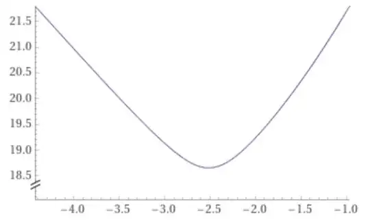

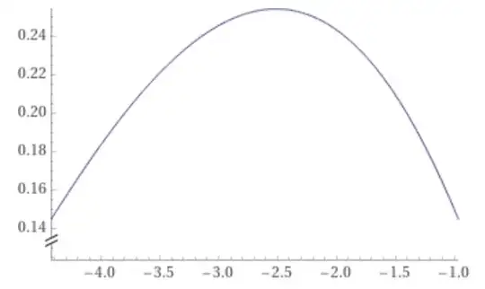

$\hspace{150pt}$ Discussion and conclusion

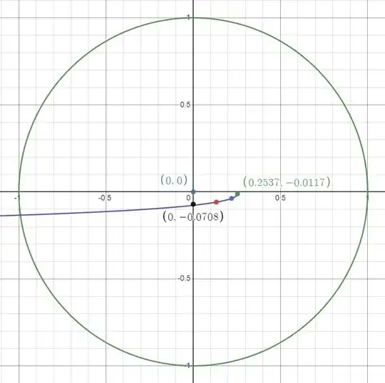

Let start with Picture 2. I think it is possible to calculate each value in Picture 2 at specific $x_{0,2}$ numerically with R. J. Mathar's method. Because of that, I think it is impossible find analytic function of the relation between $x_{0,2}$ and $|\overline{OC_2}|,P_2$ like what I find for Picture 4.
I think it is possbile to find the approximate function in form of series expansion but that is beyond my knowledge, sorry.
As Picture 2 is transition phase between Picture 1 and Picture 3, we can assume that
\begin{align} x_{0,3}<x_{0,2}<x_{0,1} &\rightarrow -0.935850<x_{0,2}<0 \\ y_{0,1}<y_{0,2}<y_{0,3} &\rightarrow 0.317324<y_{0,2}<0.352398 \\ x_{1,1}<x_{1,2}<x_{1,3} &\rightarrow 5.39554<x_{1,2}<5.75543 \\ y_{1,2}=y_{1,1} &\approx -0.264932 \\ x_{2,1}<x_{2,2}<x_{2,3} &\rightarrow -5.39554<x_{2,2}<-4.42258 \\ y_{2,2}=y_{2,1} &\approx -0.264932 \end{align}
Note : In Picture, I just use $x_{a,2}=\frac{x_{a,1}+x_{a,3}}{2}$ and $y_{a,2}=\frac{y_{a,1}+y_{a,3}}{2}$ when $a=0,1,2$ so all 5 areas aren't complete equal.
With those upper and lower limit, it is still impossible to tell if $|\overline{OC_1}|<|\overline{OC_2}|<|\overline{OC_3}|$ and $P_3<P_2<P_1$ without additional condition which I can't find and proof what they are exactly.

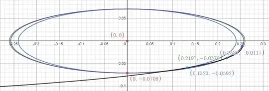

However, I can use the value I get to plot in https://www.desmos.com/calculator
$\hspace{150pt}$ Let start with centroid (C)
Picture C Desmos
Desmos code
(0,0)
x^2+y^2=1
y = (-2.22343*10^{12} x^2 - 1.45103*10^{14} (7.5*10^{9} x^2 - 8.63314*10^{10} x + 2.1424*10^{10})^{0.5} - 1.25663*10^{19} x + 1.53371*10^{17})/(8.3925*10^{12} x^2 - 9.66048*10^{13} x + 2.72416*10^{20})
(0,-0.0708467)
(0.132333,-0.059155)
(0.219683,-0.037873)
(0.253748,-0.011680)
From the graph
  • x axis is $C_x$
  • y axis is $C_y$
  • The radius of circle is 1.
  • Black dot is $C_1$
  • Red dot is $C_3$
  • Blue dot is $C_4$
  • Green dot is $C_5$
  • Purple graph is postion centroid from $C_4$ formula that we get which is qualify for $0.132333<C_x<0.253748$.
I try to fit those dot with ellipse. It fit pretty well but not fit exactly.
Picture C Desmos ellipse
Desmos code
(0,0)
x^2/(0.240477)^2+y^2/(0.0708467)^2=1
x^2/(0.259943)^2+y^2/(0.0708467)^2=1
x^2/(0.257268)^2+y^2/(0.0708467)^2=1
(0,-0.0708467)
From the graph
  • x axis is $C_x$
  • y axis is $C_y$
  • Red dot is $C_1$
  • Blue dot is $C_3$
  • Green dot is $C_4$
  • Purple dot is $C_5$
  • Black graph is postion centroid from $C_4$ formula that we get which is qualify for $0.132333<C_x<0.253748$.
  • Blue ellipse pass $C_1$ and $C_3$
  • Green ellipse pass $C_1$ and $C_4$
  • Purple ellipse pass $C_1$ and $C_5$
Here is a graph between $x_2$ and $|\overline{OC}|$
The scale of x axis and y axis is same, so we don't see much thing in Desmos in this case.
So, I use Wolframalpha to plot instead.
From left to Right, each dot are $|\overline{OC_1}|,|\overline{OC_3}|,|\overline{OC_4}|,|\overline{OC_5}|$
Here is a graph between $x_{2,4}$ and $|\overline{OC_4}|$ in range $x_{2,4}<x_{2,4}<I_{3,x,4}$ or $-4.42258<x_{2,4}<-0.964267$
Note : The formula of $|\overline{OC_4}|$ that we get still work in range $x_{2,5}<x_{2,4}<I_{3,x,4}$ or $-2.51458<x_{2,4}<-0.964267$
The maximum |\overline{OC_4}| is at $x_{2,4}=x_{2,5}$. So, $|\overline{OC_4}|\le|\overline{OC_5}|$
From all graph, it is very like that "the longest possible the distance from the center of the circle to the centroid of the triangle" $=|\overline{OC_5}|\approx0.254017$
For "the shortest possible the distance from the center of the circle to the centroid of the triangle", the value might be equalt to $|\overline{OC_1}|\approx0.0708467$ or slightly less than that in some case of Picture 2 that is very close to Picture 1.
$\hspace{150pt}$ About outer parimeter ($P$)
Here is a graph between $x_2$ and $P$
From left to Right, each dot are $P_1,P_3,P_4,P_5$
From the formula of $P_4$ we get, here is a graph between $x_{2,4}$ and $P_4$ in range $-4.42258<x_{2,4}<-0.964267$
The minimum $P_4$ is at $x_{2,4}=x_{2,5}$. So, $P_4\ge P_5$
From all graph of $P$, it is very like that "the shortest possible length of outer perimeter of new intersecting shape" $=P_5\approx18.6542$
For "the longest possible length of outer perimeter of new intersecting shape", the value might be equalt to $P_1\approx23.0702$ or slightly more than that in some case of Picture 2 that is very close to Picture 1.
