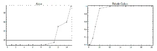

As a demonstration of these three methods, consider these two datasets due to Akima:
$$\begin{array}{|l|l|} \hline x&y\\ \hline 1&10\\2&10\\3&10\\5&10\\6&10\\8&10\\9&10.5\\11&15\\12&50\\14&60\\15&95\\ \hline \end{array}$$
and Fritsch and Carlson:
$$\begin{array}{|l|l|} \hline x&y\\ \hline 7.99&0\\8.09&2.7629\times 10^{-5}\\8.19&4.37498\times 10^{-3}\\8.7&0.169183\\9.2&0.469428\\10&0.94374\\12&0.998636\\15&0.999919\\20&0.999994\\ \hline \end{array}$$
Here are plots of these two datasets:
scatter plots

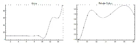

Here are plots of the cubic spline fits to these two sets:
spline fits
Note the wiggliness that was not present in the original data; this is the price one pays for the second-derivative continuity the cubic spline enjoys.

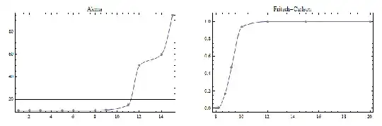

Here now are plots of interpolants using the three methods mentioned earlier.
This is the Fritsch-Carlson result:
Fritsch-Carlson

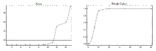

This is the Steffen result:
Steffen

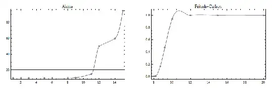

This is the Stineman result:
Stineman
(The not-too-good result for the Fritsch-Carlson data set might be due to the use of a cubic Hermite interpolant instead of the rational interpolant Stineman recommended to be used with his derivative prescription.)
As I said, I've had good experience with these three; however, you will have to experiment in your environment on which of these is most suitable to your needs.
