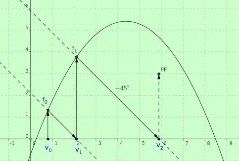

Your problem is centered on solving the difference equation $$ V_{n + 1} = V_n + f(V_n )\quad \Rightarrow \quad \Delta V_n = f(V_n ) $$
where the RHS is a function of the same $V_n$ and not of $n$ and is therefore not linear. For a general $f()$ there are not closed formulas to apply, nor a standardized algorithm.
Even the analogy with the ode $$ y'=f(y) $$ might asymptotically coincide or fail catastrofically.
In any case, for a given $f()$, you can easily graph the function and proceed like in the following graph which should be quite self explanatory.
dy=f(y)_1
That fully clarifies that you may end on a finite point or diverge to infinity, depending on the shape of $f$ , on the starting point, ...
--- in reply to your comment -----
What I am saying is that first of all you have better graph the function. This will help you to evaluate the situation. For instance for the function in the example you see that it has two zeros. If you start in between them, you will end in the 2nd zero, but iff:
  • the starting steps did not bring you already beyond that
  • in the last step, the derivative of $f$ there is negative and less than $1$ in absolute value, etc.
Having fixed that picture, then if $f()$ is "nice" enough , at least on a trait, you may approximate it and see what you can get

    So what you are saying is that there is no way to solve this other than graphically or by literally writing the function down and incrementing at each step to check if I am over A... – J.Doe Aug 29 '22 at 15:30
  • added explanation of what I mean to say – G Cab Aug 29 '22 at 15:47
  • concerning the $f(x)=300/x$ of your example, have a look at this related post concerning $f(x)=1/x$ to exemplify the difficulty concerned – G Cab Aug 29 '22 at 16:29
  • this would mean that I can only find an asymptotical if I know my exact function, correct ? – J.Doe Sep 07 '22 at 08:51
  • You need to know exactly the function as well as the starting point $V_0$. Consider the example I drew: suppose that around the zero on the right (near $x=8$) the derivative be comprised in $(-1,0)$, then if you start in that area you will end on the zero, but possibly not if you start out of that – G Cab Sep 07 '22 at 16:39
