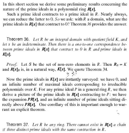

HINT $\ $ Factoring out a prime $\rm\:p \ne 0\:$ reduces it to finding a chain of two prime ideals in $\rm\:\mathbb F_p[x]\:.$
A similar reduction tackles lhf's question in the comments - see Theorem 37 below from Kaplansky's Commutative Rings. (Theorem 34 is the bijective order-preserving correspondence between prime ideals in a localization $\rm\:R_S\:$ and all prime ideal in $\rm\:R\:$ disjoint from $\rm\:S\:$).
