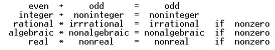

As I mention here frequently, this ubiquitous property is simply an instance of complementary view of the subgroup property, i.e.
THEOREM $\ $ A nonempty subset $\rm\:S\:$ of abelian group $\rm\:G\:$ comprises a subgroup $\rm\iff\ S\ + \ \bar S\ =\ \bar S\ $ where $\rm\: \bar S\:$ is the complement of $\rm\:S\:$ in $\rm\:G$
Instances of this are ubiquitous in concrete number systems, e.g.
Bill Dubuque
