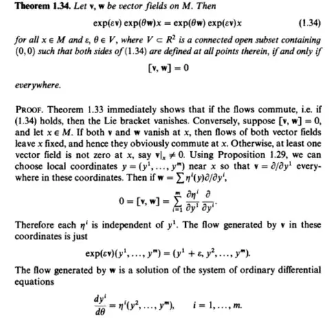

I don't quite understand the proof of one of the theorems from the Peter J. Olver's book Applications of Lie groups to differential equations (2e) :

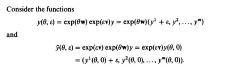

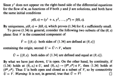

I don't understand why $U$ is open. It is clear for me why the set $$ \hat W=\{ (\theta,\varepsilon):\; y(\theta,\varepsilon)=\tilde y(\theta,\varepsilon) \} $$ is open. Does it coincide with the set $\hat U$? If yes, why? Proposition 1.29 mentioned in the text asserts only the local existence of coordinates in which the vector field $\mathbf v$ is rectifiable. How do we know that the corresponding change of variables is valid for the entire set $\hat W$? If we do not know this, and $\hat W\ne \hat U$, then, apparently, the "rectifiability set" of the vector field $\mathbf v$ must be open. But why?

It seems the main confusion is due to the way the theorem is phrased; below I'll paraphrase it in a slightly more rigorous way, which I hope will clarify the broader issue. But before that, shortly:
Does [$\hat{W}$] coincide with the set $\hat U$?
No, strictly speaking: For $\hat{U}$ one fixes the basepoint $x$, for $\hat{W}$ any anonymous point $y$ close enough to $x$ ought to work.
You are right that we don't have global (in time) flowboxes necessarily. (e.g. consider the $2$-torus $M=\mathbb{T}^2$ and vertical and horizontal flows on $M$; see e.g. Dynamics on the torus)
Even though $\hat{W}$ is not quite the same as $\hat{U}$, it is likely that the openness of $\hat{U}$ is justified in a way similar to the way that makes it clear to you $\hat{W}$ is open.

Let me now rephrase the theorem and part of the proof. The main idea is that two local flows commute iff they commute infinitesimally.
Theorem: Let $M$ be a $C^\infty$ manifold, $X,Y$ be $C^2$ ($\dagger$) vector fields on $M$. Denote by $\phi$ and $\psi$ the local flows of $X$ and $Y$, respectively. Then the following are equivalent:
  1. For any $p\in M$, there is an open connected subset $V_p\subseteq \mathbb{R}^2$ containing $(0,0)$ such that for any $(\epsilon,\eta)\in V_p$ we have $\phi_\epsilon\circ\psi_\eta(p)=\psi_\eta\circ\phi_\epsilon(p)$.
  2. $[X,Y]=0$.

Fix a basepoint $p\in M$. First note that $B_p^{X,Y}$ is open in $\mathbb{R}^2$. Indeed, by definition we have
\begin{align*} B_p^{X,Y} =&\{(\epsilon,\eta)\in\mathbb{R}^2\,|\, (\eta,p)\in\mathfrak{D}(Y), (\epsilon,\psi_\eta(p))\in \mathfrak{D}(X)\}\\ &\cap \{(\epsilon,\eta)\in\mathbb{R}^2\,|\, (\epsilon,p)\in\mathfrak{D}(X), (\eta,\phi_\epsilon(p))\in \mathfrak{D}(Y)\}\\ = & \left\{(\epsilon,\eta)\in\mathbb{R}^2\,\left|\, \eta\in J_p^Y, \epsilon\in J_{\psi_\eta(p)}^X\right\}\right.\\ &\cap \left\{(\epsilon,\eta)\in\mathbb{R}^2\,\left|\, \epsilon\in J_p^X, \eta\in J_{\phi_\epsilon(p)}^Y\right\}\right.. \end{align*}
Thus for $(\epsilon,\eta)\in B_p^{X,Y}$, since $\mathfrak{D}(X)$ is open in $\mathbb{R}\times M$, there is an open interval $I_1$ and an open subset $N\subseteq M$ such that $(\epsilon,\psi_\eta(p))\in I_1\times N\subseteq \mathfrak{D}(X)$. Since $\psi$ is continuous and $J_p^Y$ is an open interval there is an open interval $I_2\subseteq J_p^Y$ such that $\eta\in I_2$ and $\psi(I_2\times \{p\})\subseteq N$; whence $I_1\times I_2\ni (\epsilon,\eta)$ is included in the first set (which is the "$p$-slice" of $\operatorname{dom}(L)$) defining $B_p^{X,Y}$. A similar argument shows that the second defining set is also open, hence $B_p^{X,Y}$ is open in $\mathbb{R}^2$.
Define $C_p^{X,Y}$ ( = $V$ in Olver's notation) to be the connected component of $B_p^{X,Y}$ containing $(0,0)$. Then $C_p^{X,Y}$ is open both in $B_p^{X,Y}$ and $\mathbb{R}^2$ (see e.g. connected components of open sets are open). Say we could show that $A_p^{X,Y}$ is an open subset of $B_p^{X,Y}$ (or $\mathbb{R}^2$). Then $A_p^{X,Y}\cap C_p^{X,Y}$ (= $U$ is Olver's notation) would be an open subset of $C_p^{X,Y}$. By continuity of the local flows $\phi$ and $\psi$, $A_p^{X,Y}\cap C_p^{X,Y}$ is also closed in $C_p^{X,Y}$, thus $A_p^{X,Y}\cap C_p^{X,Y}= C_p^{X,Y}$, that is $A_p^{X,Y}\subseteq C_p^{X,Y}$; in particular $A_p^{X,Y}$ would be connected.
Thus it suffices to show that $A_p^{X,Y}$ is open; for this Olver assumes $[X,Y]=0$ (we didn't need to use this until now) and argues that two sides coinciding not only for the initial condition $p$ but everywhere in a local chart around $p$ is an open condition in the time space, that is, that $\hat{W}$ in your notation is open. Since you seem to have no trouble with this part I'll stop here; the idea is again to use the Existence and Uniqueness theorem.

    Yes, indeed. I got stuck because for some reason I thought that the rectifying change of variables is the same on the entire set, although it may be different at different points. So, we don't need $\hat W$ at all. Thank you for your response! – AVK Aug 17 '22 at 18:36
