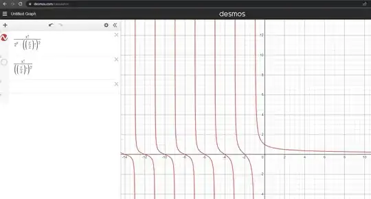

If one graphs $$ y= \frac{\Gamma(x+1)}{2^x \Gamma(\frac{x}{2}+1)^2} = \frac{x!}{2^x \left( \left( \frac{x}{2}\right)!\right)^2} $$
One immediately notices that as $x \rightarrow -\infty$ the function tends to some periodic function that looks an awful lot like $\tan(x)$. Is there a way to make this idea precise and state what that function is? I was thinking something like, there exists a periodic function $f(x)$ such that $f(x) - y(x) \rightarrow 0$ as $x \rightarrow -\infty$.
See this image:
Which was produced using desmos.com/calculator

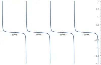

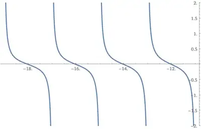

$\dfrac{\tan(-\pi x/2)}{\sqrt{-\pi x/2}}$ is not periodic, though it appears to be over short spans. As $x\to-\infty$, the tangent-like shapes get flattened out.
Here is how they look near $x=-15$:
and here is how they look near $x=-1005$:
