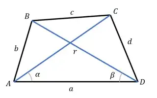

Label the trapezoid as the shown below. The base of the quadrilateral is $\overline{AD}$. The lengths of the sides $\overline{AB},\overline{BC},\overline{CD},\overline{AD}$ are respectively $b,c,d$, and $a$. The diagonals $\overline{AC}$ and $\overline{BD}$ both have length $r$. Angles $\angle BAC$ and $\angle CAD$ are both $\alpha$, while $\angle ADB$ and $\angle BDC$ are both $\beta$.
diagram
Now because of how we define the "inside" of the quadrilateral, it must be the case that $2\alpha<\pi$ and $2\beta<\pi$. Furthermore, since $\overline{AB}$ and $\overline{BC}$ must intersect, $2\alpha+\beta<\pi$. Likewise, $\alpha+2\beta<\pi$.

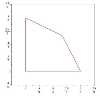

This valid region for $\alpha$ and $\beta$ is shown below, excluding the boundary.
Note that because of this range of allowable values of $\alpha$ and $\beta$, the sines and cosines of these angles are positive.
Now, by equating expressions for the positions of points $B$ and $C$, we get the following equations.
$$\begin{align*} r\cos\alpha&=a-d\cos2\beta & &(1)\\ b\cos2\alpha&=a-r\cos\beta & &(2)\\ r\sin\alpha&=d\sin2\beta & &(3)\\ a\sin2\alpha&=r\sin\beta & &(4)\\ \end{align*}$$

$$(4\sin\alpha\cos\alpha\sin\beta\cos\beta-4\sin^2\alpha\sin^2\beta+2-2(\cos^2\alpha+\cos\alpha\cos\beta+\cos^2\beta))<0$$
for all $\alpha$ and $\beta$ in the legal range†. (It is exactly zero at $\alpha=0,\beta=\frac{\pi}{2}$ and vice versa.) This means that

Now clearly the base angles $2\alpha$ and $2\beta$ are equal. By SAS congruence, we get that $\triangle ABD$ and $\triangle DCA$ are congruent. Therefore the base side lengths $b$ and $d$ are equal.
Verified graphically. A full proof would likely include function maximization to show that the expression does not exceed $0$.

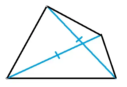

Old Answer: Question was asked without angle bisection constraint.
The diagonals of a quadrilateral being congruent is not sufficient to prove that the quadrilateral is an isosceles trapezoid. Consider the quadrilateral shown below:
