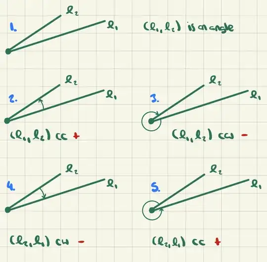

I'd like to post what I've gleaned so far from comments/answers/references.

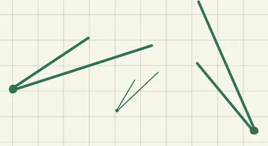

In Euclidean geometry, an angle is just a vertex and two rays.
However, "angle" is also used to designate the measure of a Euclidean angle, where measure is just the ratio of a circular arc centered at the vertex to the radius of the circular arc. This is, however, ambiguous because there are two possible circular arcs.
Wikipedia says
The size of a geometric angle is usually characterized by the magnitude of the smallest rotation that maps one of the rays into the other.
which means the first angle in the picture above is "usually" the one referred to when we say "angle" and are referring to the specific vertex and rays in the picture above.
Moving on, a measure or magnitude is always non-negative, so angles are always non-negative.
Angles that have the same measure (ie the same magnitude) are said to be equal.
Given the ideas above, it seems that under Euclidean geometry, the following angles are all different, but if we use the word "angle" as the measure of a Euclidean angle in the "usual" sense as described by Wikipedia, then the following angles are all equal.
It is possible for two angles to have the same Euclidean angle specification (same vertex, same rays), but to have a measure that differs by an integer multiple of a turn of the chosen circular arc used to measure the angles. These angles are called coterminal, and any angle has an infinite number of coterminal angles.

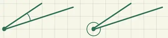

Next, we move on to the notion of a directed angle, which I believe is closely tied (or is perhaps the same as) the notion of a "signed angle" as I see in Wikipedia.
A convention is used to allow positive and negative angular values to represent orientations and/or rotations relative to some reference. In a 2D Cartesian coordinate system, this reference is the positive x-axis.
We then name the two sides of the Euclidean angle as initial side and terminal side, and we measure from initial to terminal. The directed angle is positive if this measurement is made with a counterclockwise orientation, and it is negative if the measurement is with a clockwise orientation.
Note that the notions of clockwise and counterclockwise depend on the x-axis being positive to the right.
I've been wondering all along what exactly is the specification of a directed angle?
Consider the five examples below
If $l_1$ and $l_2$ are rays (and I am assuming that however we specify the rays it includes the specification of the vertex), then $(l_1,l_2)$ specifies the Euclidean angle $1$.
$2, 3, 4$, and $5$ are directed angles.
Take $2$ for example. Is the specification "$(l_1,l_2)$ counterclockwise"?
If we make it a convention that if we omit the orientation then the default is counterclockwise, then $(l_1,l_2)$ specifies $2$.
