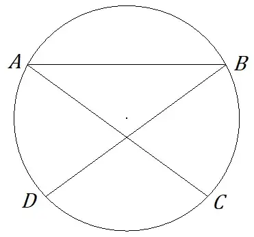

Without a calculator, determine whether chords $AB, AC \text{ and }BD$ can divide a circle into five equal-area regions.
Context: I just made up this question.
I have only been able to answer the question with a calculator. Surely there must be some clever way to answer the question without a calculator.

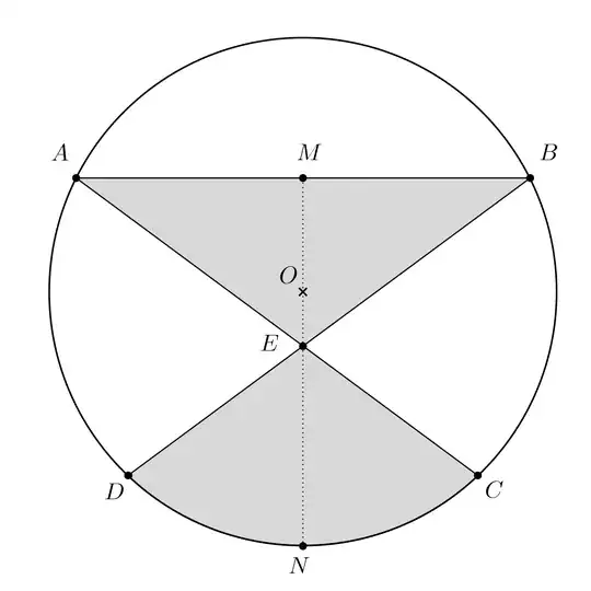

Let us assume that the radius of the circle is $1$ and let $\widehat{BOA}=2\theta$.
Then $\theta$ is the unique solution of $\theta-\frac{1}{2}\sin(2\theta)=\frac{\pi}{5}$ and $AB=\sin(2\theta)$.
$[AEB]=\frac{\pi}{5}$ then implies $ME=\frac{\pi}{5\sin\theta}$ and $AE=EB=\sqrt{\sin^2\theta+\frac{\pi^2}{25\sin^2\theta}}$.
The height of the circle segment with base $AB$ is $1-\cos\theta$, so by naming $P$ the antipode of $N$ we have $EP=1-\cos\theta+\frac{\pi}{5\sin\theta}$ and $EN=1+\cos\theta-\frac{\pi}{5\sin\theta}$. By the chords theorem $EN\cdot EP = EC\cdot EA$, hence
$$ EC = \frac{1-\left(\cos\theta-\frac{\pi}{5\sin\theta}\right)^2}{\sqrt{\sin^2\theta+\frac{\pi^2}{25\sin^2\theta}}}$$ and by the similarity between $EAB$ and $ECD$ we have
$$ CD = \frac{1-\left(\cos\theta-\frac{\pi}{5\sin\theta}\right)^2}{\sin^2\theta+\frac{\pi^2}{25\sin^2\theta}}\cdot 2\sin\theta$$ and
$$ \widehat{DOC} = 2\arcsin\left(\frac{1-\left(\cos\theta-\frac{\pi}{5\sin\theta}\right)^2}{\sin^2\theta+\frac{\pi^2}{25\sin^2\theta}}\cdot \sin\theta\right).$$ The length of $OE$ is $\frac{\pi}{5\sin\theta}-\cos\theta$, hence the area of the quadrilateral $DOCE$ equals
$$ [DOCE] = \left(\frac{\pi}{5\sin\theta}-\cos\theta\right)\left(\frac{1-\left(\cos\theta-\frac{\pi}{5\sin\theta}\right)^2}{\sin^2\theta+\frac{\pi^2}{25\sin^2\theta}}\cdot \sin\theta\right) $$ and the area of the portion of the circle bounded by $E,D,C$ equals
$$\arcsin\left(\frac{1-\left(\cos\theta-\frac{\pi}{5\sin\theta}\right)^2}{\sin^2\theta+\frac{\pi^2}{25\sin^2\theta}}\cdot \sin\theta\right)-\left(\frac{\pi}{5\sin\theta}-\cos\theta\right)\left(\frac{1-\left(\cos\theta-\frac{\pi}{5\sin\theta}\right)^2}{\sin^2\theta+\frac{\pi^2}{25\sin^2\theta}}\cdot \sin\theta\right).$$
Few steps of Newton's method give $\theta\approx 1.05657$, hence the last expression is $\approx 0.552681$ while $\pi/5\approx 0.628319$, proving that the wanted pentasection is impossible.

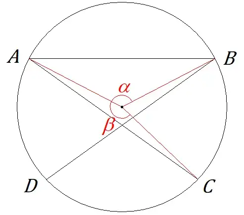

$\huge{\text{Proof by contradiction: assume the answer is yes}.}$
$\huge{\text{Define $\alpha$ and $\beta$}.}$
Let radius $=1$.
Call the centre $O$.
$\alpha=\angle{AOB}$
$\beta=\angle{AOC}$

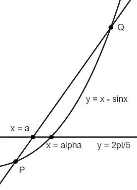

$\huge{\text{Show that }\alpha>2.1.}$
$2\times\text{Area}_{\text{minor segment }AB}=\alpha-\sin{\alpha}=\dfrac{2\pi}{5}$
Between $P\left(\dfrac{2\pi}{3},\dfrac{2\pi}{3}-\dfrac{\sqrt3}{2}\right)$ and $Q\left(\dfrac{3\pi}{4},\dfrac{3\pi}{4}-\dfrac{\sqrt2}{2}\right)$, the curve $y=x-\sin{x}$ is concave up, so the curve lies to the right of line segment $PQ$.
We can show that $P$ is below $y=\dfrac{2\pi}{5}$, and $Q$ is above $y=\dfrac{2\pi}{5}$:
$\dfrac{2\pi}{3}-\dfrac{\sqrt3}{2}<\dfrac{2(3.15)}{3}-\dfrac{1.7}{2}=1.25<1.256=\dfrac{2(3.14)}{5}<\dfrac{2\pi}{5}$
$\dfrac{2\pi}{5}<\dfrac{2(3.2)}{5}=1.28<1.45=\dfrac{3(3)}{4}-0.8<\dfrac{3\pi}{4}-\dfrac{\sqrt2}{2}$
Let $a=$ x-coordinate of intersection of $y=\dfrac{2\pi}{5}$ and line segment $PQ$.
$\alpha >a=\dfrac{\frac{2\pi}{5}+\frac{9\sqrt3}{2}-4\sqrt2}{1+\frac{6}{\pi}(\sqrt3-\sqrt2)}>\dfrac{0.4(3.14)+4.5(1.732)-4(1.415)}{1+\frac{6}{3.14}(1.733-1.414)}=\dfrac{3.39}{\frac{5.054}{3.14}}>\dfrac{3.39}{1.61}>2.1$

$\huge{\text{Show that }\angle{BAC}<0.6816}.$
$\angle{BAC}=\dfrac{1}{2}{\angle{BOC}}=\dfrac{1}{2}{\left(2\pi-\alpha-\beta\right)}<\dfrac{1}{2}(2(3.1416)-2.1-2.82)=0.6816$

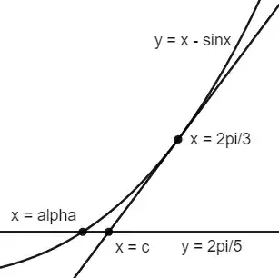

Between $(0,0)$ and $(\pi,\pi)$, the curve $y=x-\sin{x}$ is concave up, so the curve lies to the left of the tangent to the curve at $x=\dfrac{2\pi}{3}$.
Let $c=$ x-coordinate of intersection of $y=\dfrac{2\pi}{5}$ and the tangent to the curve at $x=\dfrac{2\pi}{3}$.
$\alpha<c=\dfrac{\sqrt3}{3}+\dfrac{22\pi}{45}<\dfrac{1.74}{3}+\dfrac{22(3.15)}{45}=2.12$

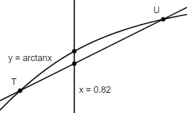

Between $T\left(\sqrt{5-2\sqrt5}, \dfrac{\pi}{5}\right)$ and $U\left(1, \dfrac{\pi}{4}\right)$, the curve $y=\arctan{x}$ is concave down, so the curve lies above line segment $TU$, which has equation $y=\dfrac{\frac{\pi}{20}}{\sqrt{5-2\sqrt5}-1}(1-x)+\dfrac{\pi}{4}$.
$\angle{BAC}>\arctan{0.82}>\dfrac{\frac{\pi}{20}}{\sqrt{5-2\sqrt5}-1}(1-0.82)+\dfrac{\pi}{4}>\dfrac{\frac{3.141}{20}}{0.727-1}(0.18)+\dfrac{3.141}{4}>0.6817$
