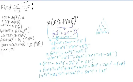

This came up when trying to evaluate $\sum n^3/2^n$. In order to do this I had to repeatedly differentiate and multiply by $x$ to make the function match the summation. What are these numbers, and why do they show up here? I would appreciate some more insight as to how exactly these coefficients of the expansion come about through this iterated process

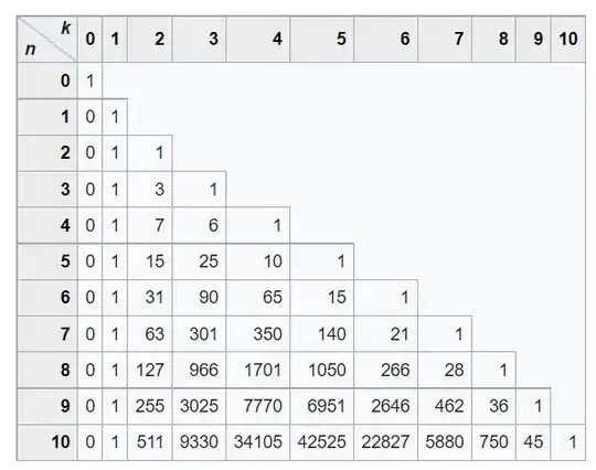

A check on the OEIS, entry $A000278$ suggests these coefficients are the (reflected triangle of the) Stirling numbers of second kind.
The Stirling numbers of the second kind (Wikipedia) give the number of ways to partition an $n$-member set into $k$ nonempty and unlabeled subsets. One may algebraically define
$$\newcommand{\S}[2]{{#1 \brace #2}} \S n k := \frac{1}{k!} \sum_{i=0}^k (-1)^i \binom k i (k-i)^n $$
Wikipedia offers a table of some values:
Notice how if you left-align your triangle, strip away the below table's first column, and then reverse the order of entries in your triangle (or Wikipedia's), you get a match.
I have no particular insight as to why these numbers pop up in your summation, however.
