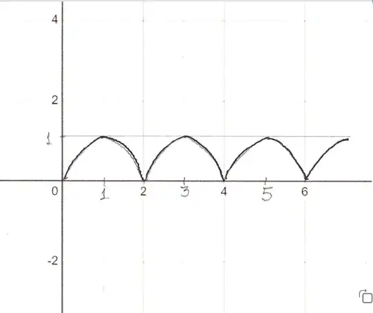

One thing that remained unresolved is whether the equality is true when $a=0$ and $b=T$ the period of the function $h$. I have tried many $h$ of trigonometrical form and the result seems to be correct. But I think the following example disproves even this case.
Let h be defined as follows:
$h(x)=1-(x-1)^{2}$ on $[0,2]$
$h(x)=1-(x-3)^{2}$ on $[2,4]$
$h(x)=1-(x-5)^{2}$ on $[4,6]$ e.t.c.
which has period $T=2$ and the following graph:
Every $nx$ belongs to some $[2n,2n+2]$ where the function $h(x)=1-[x-(2n+1)]^{2}$. Calculating (for $g(x)=x$) the integral:
$\int_{0}^{2}x[1-(nx-(2n+1))^{2}]dx$=$-\dfrac{4}{3}n^{2}-\dfrac{8n}{3}$
which tends to $-\infty$, while the r.h.s. integrals are finite!! Sorry for any errors in the integration!
