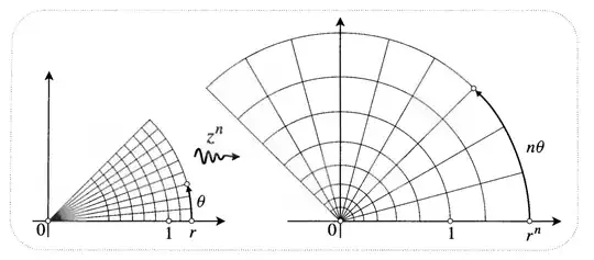

In his book, Visual Complex Analysis, Needham gives a very beautiful visualization of the geometry of this:
Note that this is an excerpt from Needham's book, Visual Complex Analysis, used under fair use, not something I own copyright to. SE policy seems to allow this. (Note that this is an excerpt from his book used under fair use.)
(Actually, Needham gives lots of awesome visualizations like this, and I'd encourage people to look at the book. It's an amazing work of mathematical exposition.)
Notice how argument scales as we raise the power, and magnitude is exponentiated!

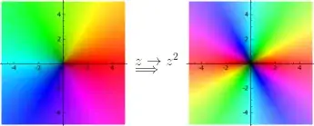

Another way to look at this is using colors! We map each complex number to a color, with hue being argument and brightness being magnitude. In this example, we square:
Notice how the argument (hue) cycles twice as fast in the image as we go around, because it changes twice as fast (being multiplied by 2)!

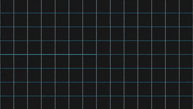

Raising to a complex power!
Let's start by just looking at a visualization of what happens when we raise to powers on the complex unit circle. The proper version is animated, and you can see it here, but since i can't embed a GIF, here's a still image:
The argument and magnitude switch places! Something really interesting must happen!

I'm more than a decade late but I think I have something to add. Complementing colah's answer, you can reorganize $e^{\ln(r)a+ib\ln(r)+iaθ−bθ}$ as the following:
$$\begin{align*} e^{\ln(r)a+ib\ln(r)+iaθ−bθ}&=e^{a(\ln(r)+i\theta)+b(-\theta+i\ln(r))}\\ &=(e^{\ln(r)}e^{i\theta})^a(e^{-b\theta}e^{i\ln(r)})^b\\ &=(r^ae^{ia\theta})(e^{-b\theta}e^{ib\ln(r)}) \end{align*}$$
And you can view that as the multiplication of two complex numbers, (somewhat) analogue to exponentiation of real numbers being a form of multiplication. To me, this relation makes it easier to see how the argument and the modulus change places. Also, if you have difficulty with domain coloring (like I do), I made this animation that's essentially the same as the one colah has provided. It pictures $z^w$ for every $z$ in the complex plane and for every $w$ on the unit circle.
